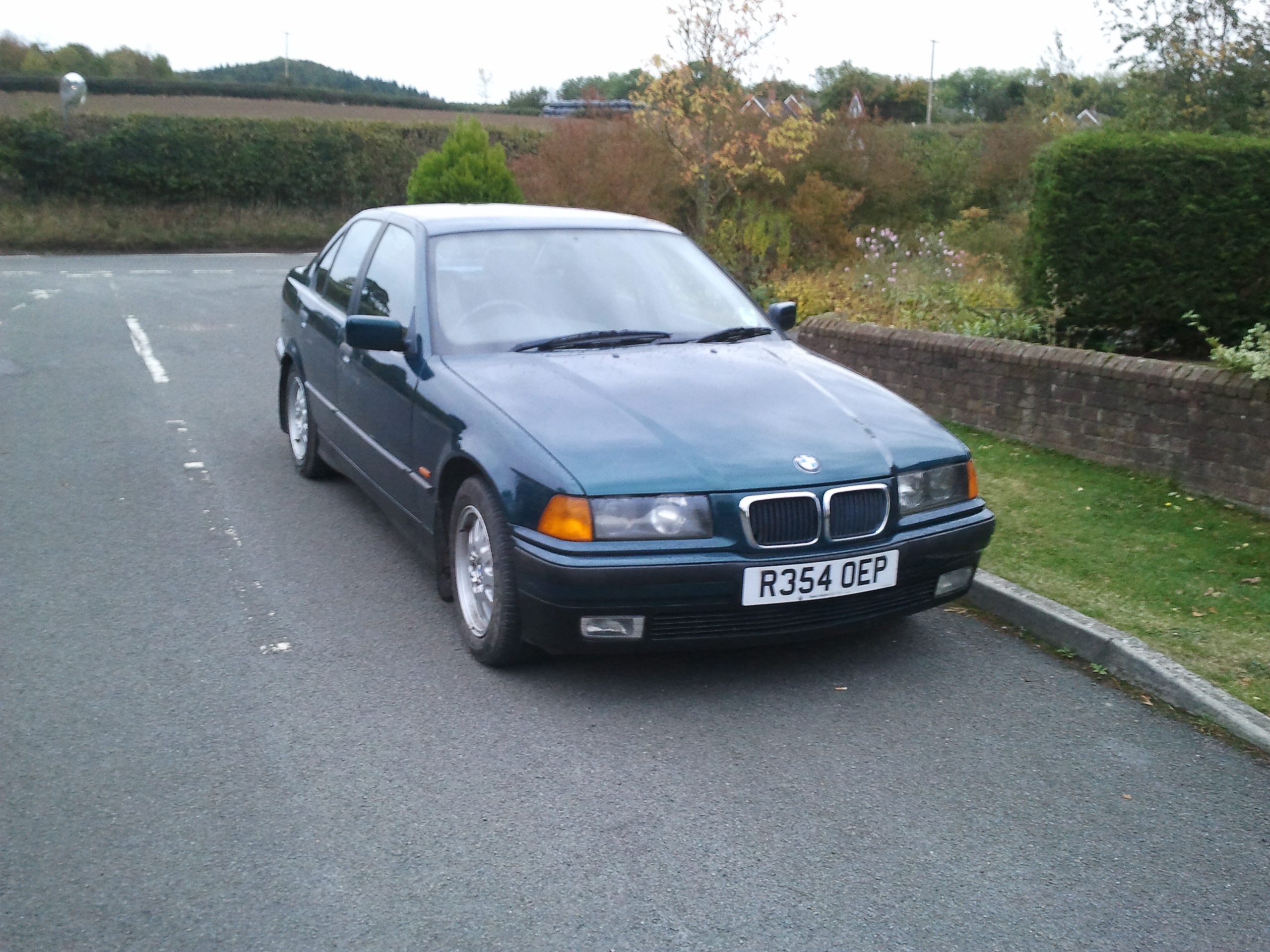

i had to buy a motor and came across my 316 which is a lovely motor, now im not sure what model it is but im guessing its a E46
i think but not sure on that score. its a 316 on a r plate on a 1997.
now the worries i have is the front suspension, when going round corners the mud flaps are scaping the floor when going round
not just sharp corners but what i would call just normal corners at normal speeds. this also happens if you go over a bumpy road too.
i have to say im a little worried about it cos it goes right through me when i hear it. like i said i have had a quick look round
here under the common problems and dont know if im looking in the right place but i was wondering if it could be the control arm,
i also think it could be the shocks or springs. she dont look low when looking at her though and she hasnt been lowered either.
she has done 124k and i see the off side shock is a little wet giving me the impression that it could be the shocks, but i havnt a clue
not with never owning a bmw before.
