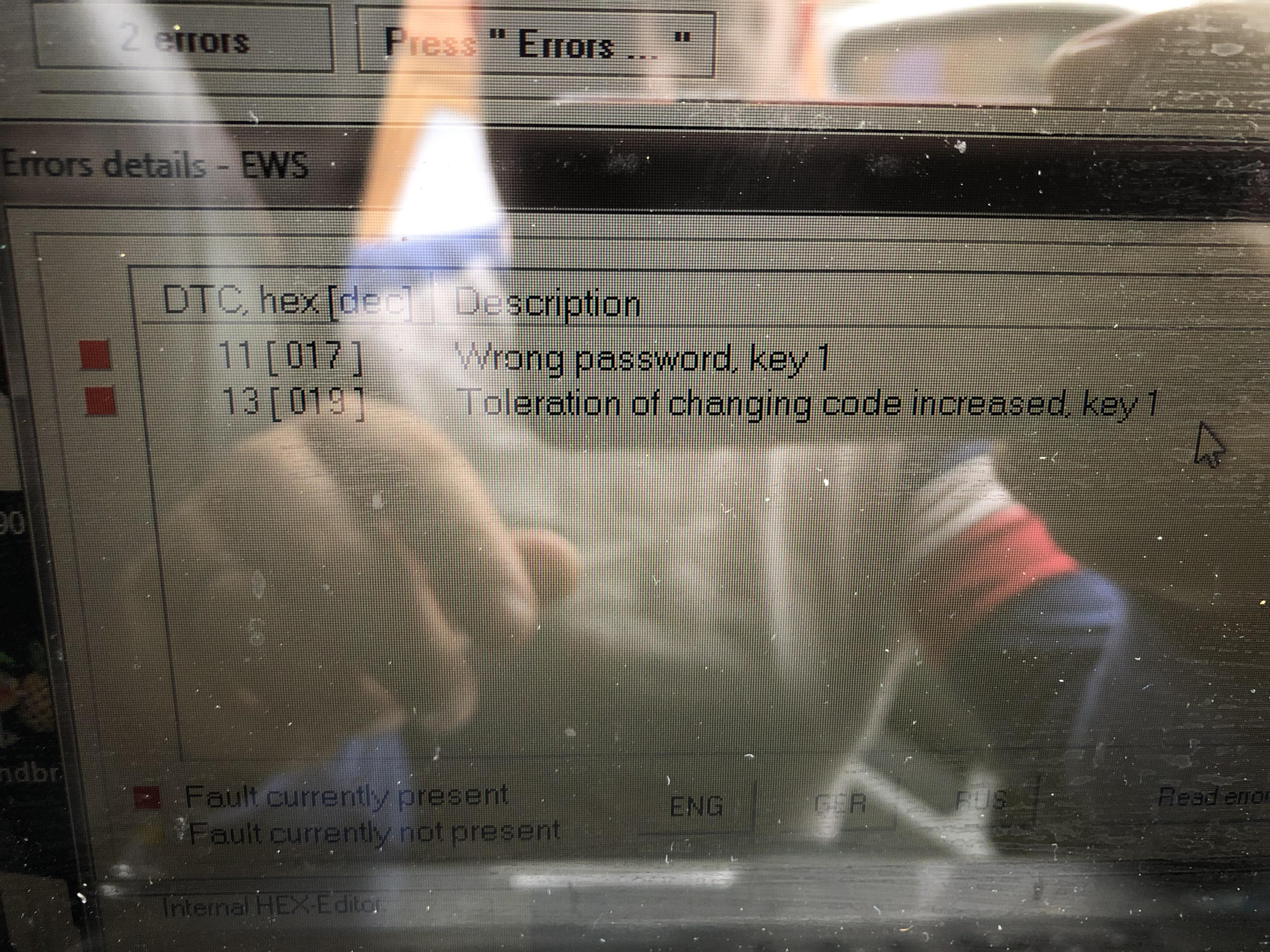

stopped and started numerous times… all ok, removed the key and locked/ unlocked the car…. No start… checked the codes and dtc 11(17) wrong password, key 1 is up… 3 cranks later and starts… I think I’m getting somewhere slowly

check pasoft and it shows the errors. Clear codes and all good until I lock the car. It’s as if the rolling code isn’t being recognised.

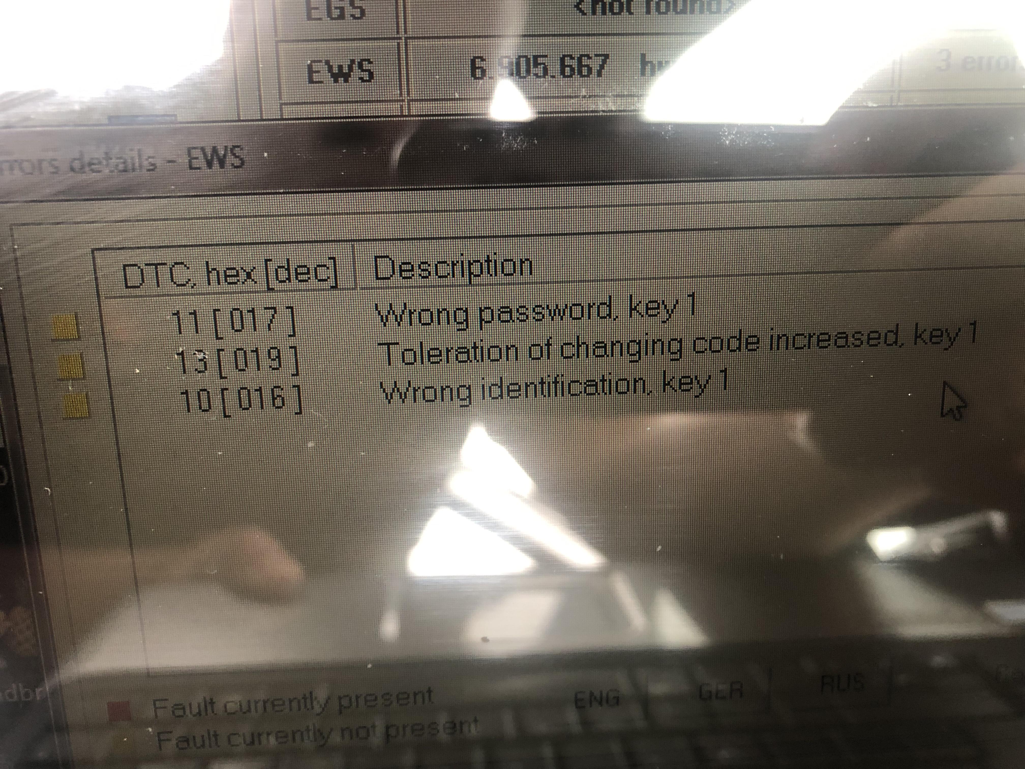

on the ews live data, the top 3 (security coding) keep changing from green to red and back. And then go blank on the data boxes.

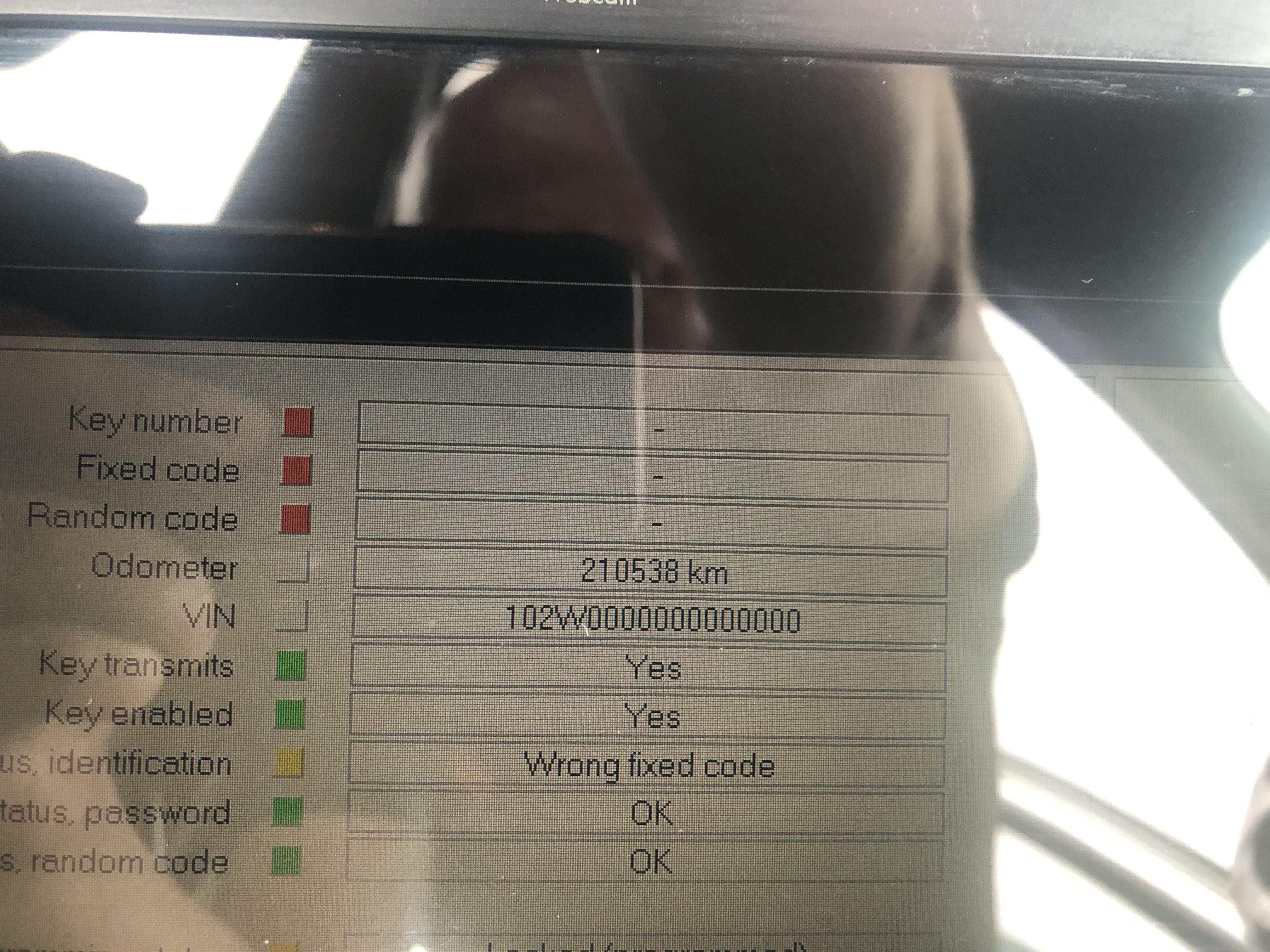

Pic1 above shows Odometer reading and Vin the Vin just doesn't look right, is it? If not it may need correcting though I have never seen one alter before.

Are you sure about the Vin number in the picture above does it match the Vin plate ?? I ask because I just tried it in realoem and it brings up a 1981/94 E30 Touring ??
