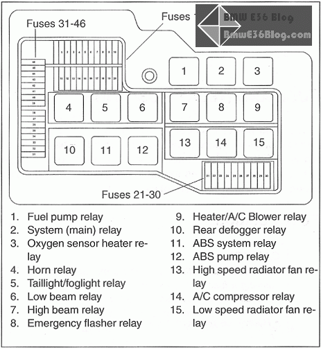

As for checking the relays, I have no idea how to.
Are any of the relays the same so I could just swop them over to check?
I doubt it's relays now though from the info you given, but try relay 2 as I'm no sure what this does
