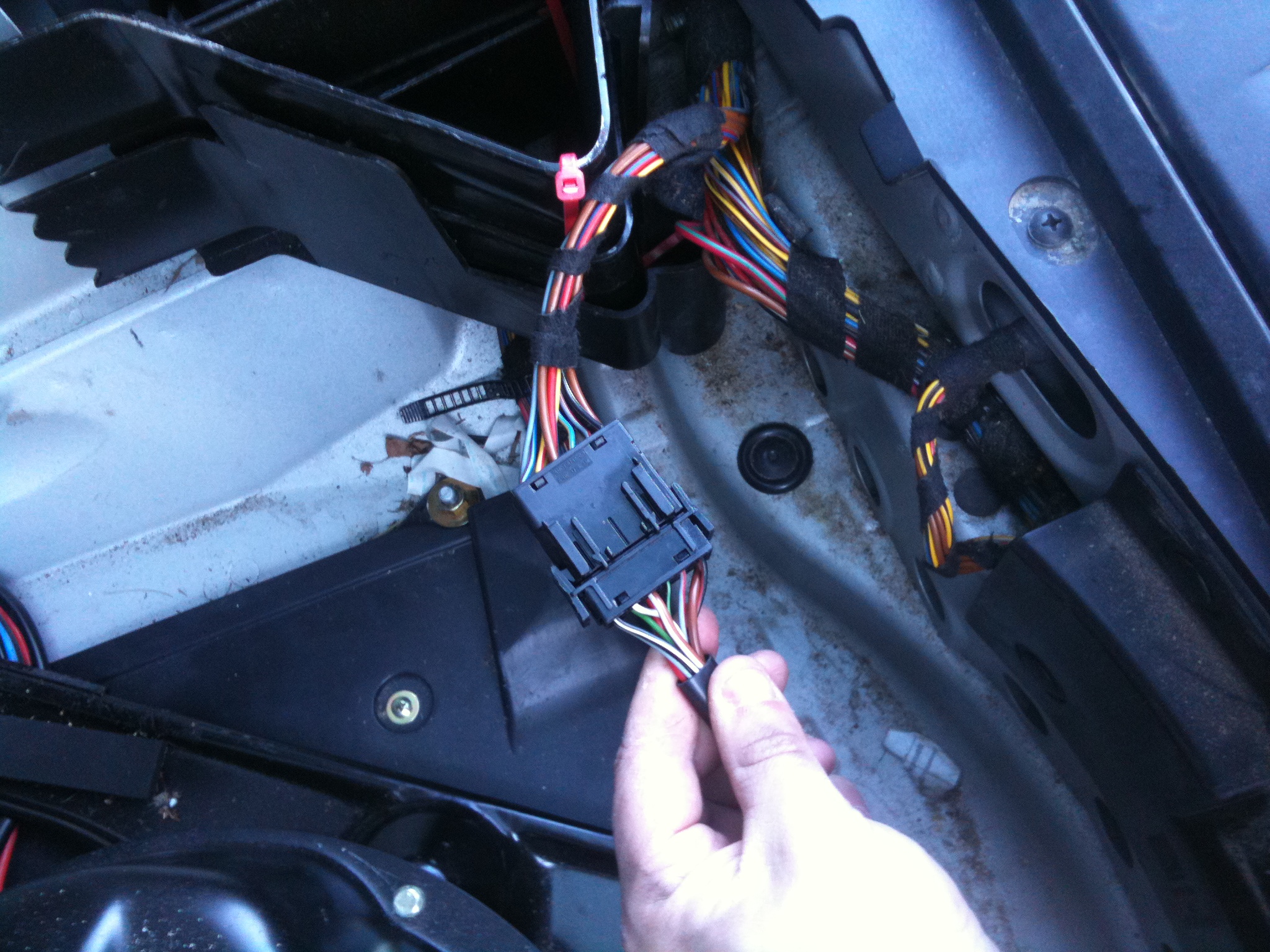

Hi all, I have a 2002 E53 X5 3.0i
I am a new member and have been members of cubs ect before. I know they can be really helpful
Unfortunately I come with problems :)

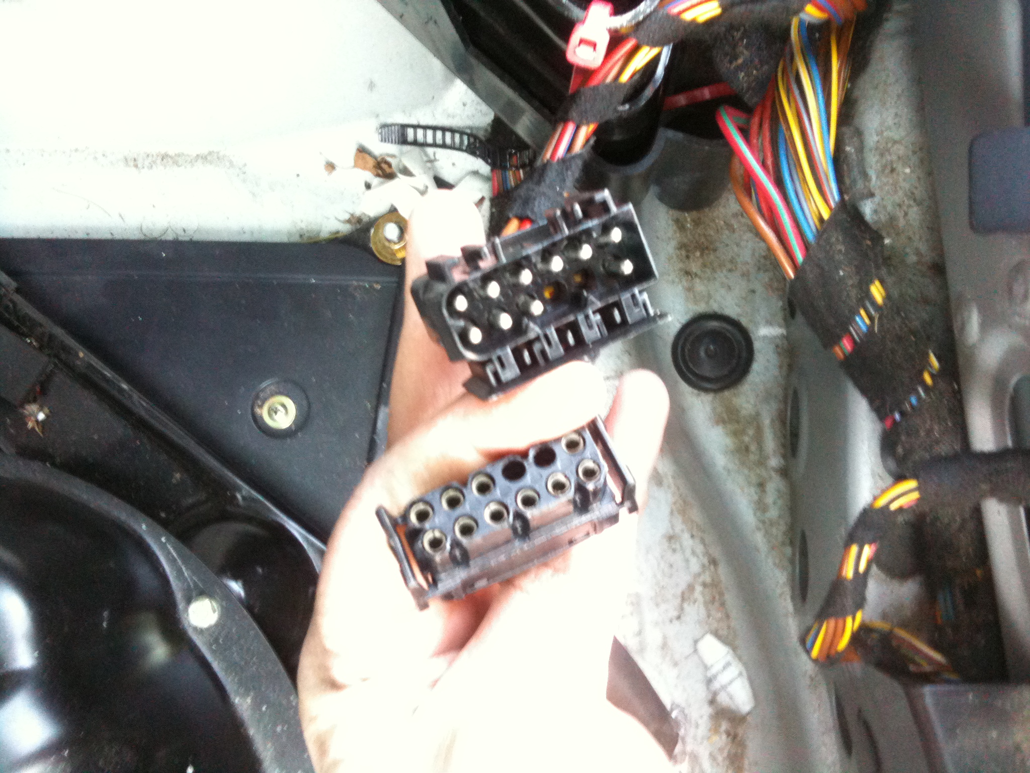

I have the 13 pin westfila towing wiring but I cant get the lights to work on my caravan. The water pump interior lights all work tho?
I was told it plugs in on the drivers side connection in the spare wheel bay. I have found the connection that matches perfectly so am I going wrong somewhere?
The pics are attached
Thanks in advance Andy
post-1006-0-94174100-1300025057_thumb.jp
post-1006-0-21977800-1300025098_thumb.jp

Have a good look at the wiring sequence in and out of that plug and notice any differences...
Make sure they match at least ! Maybe even get a tester on the powered lines whilst your side lights are on... Working thru hazards too with the same method...

The fittings match perfect too, I seen the westfila site and they said its under the battery cover but that connection seems to big and does not fit.
Its defiantly my car. The connection I have is 13 pin connection for the van right down too the connection in the pic. i there another connection ??
really at a loose end

Turns out I am missing the VDO trailer hitch module in a casing next to the battery.....
Fuming! I got the wiring from ebay used but was told thats all I needed.
BMW want near £160 for the little box and Near £75 for coding if required. (not likely)as per there parts dept'
Does anyone have one that they can provide the part number from please? Or unused ;) I can buy?? lol
That way I can try breakers ect.
Gutted! :(
Really do appreciate the help
this is the part I need.
61356955253
I have the wiring but not this box. I have read on the net now for days and cant find one can anyone help at all?
