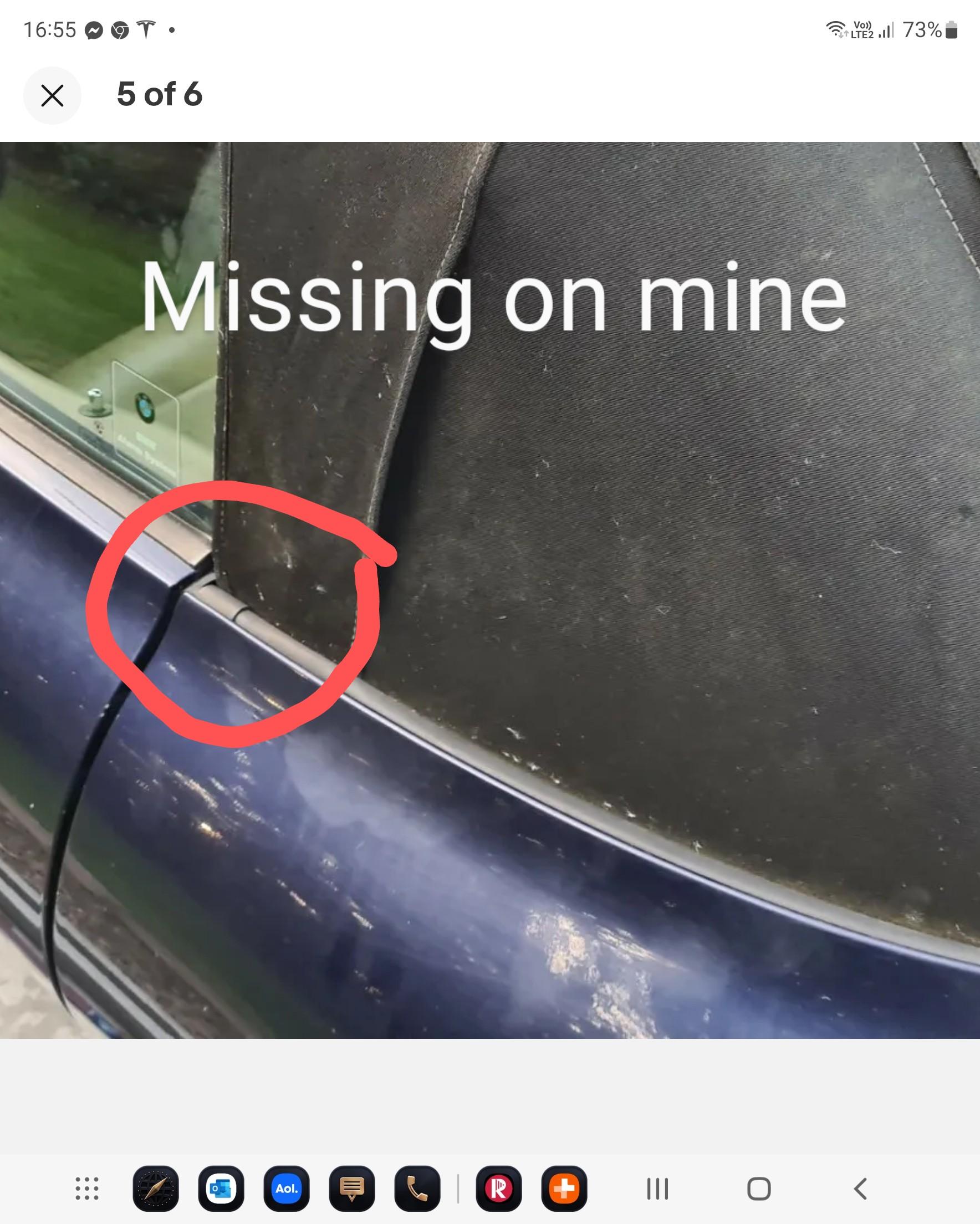

Hi all, I have x2 small seals missing where the Soft top meets the Top of the Door pillar. I can see water getting in through here then running through into the boot ? Apparently they are made of Plastic? Any ideas on sourcing ?

Getting there now, check www.realoem.com put the last 7 digits of your Vin number into the search box it will call up your model then check the roof and trim sections for what you need, don't forget any clips and fasteners
The small exploded drawings should help identify how things go together. As for sources once you have the Part Numbers BMW Dealers then the internet just google the Part numbers
