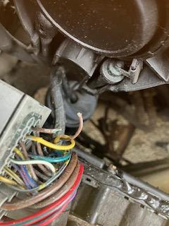

Finally found the problem can low at the ASC sensor wire had corroded through just before the multiplug. Found it by finally following the diagram and continuity checks. It wasn't as obvious as it looks in the photo as the insulation was covering it, just a speck of green I noticed after putting on two pairs of glasses. Thanks for your replies.
