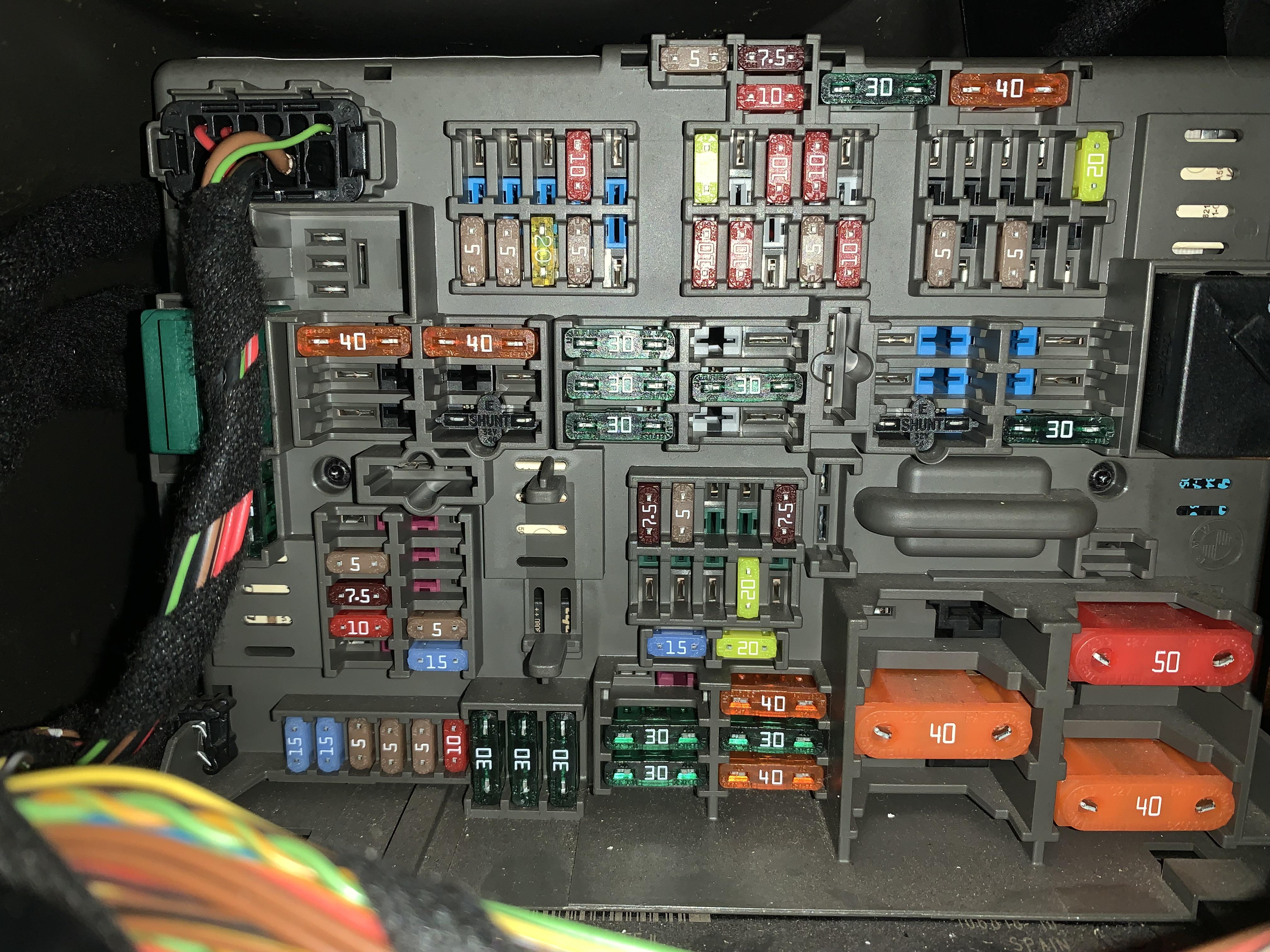

I also bought the Hard Wire to plug into the fuse box. My question is which space do I plug it in, everything on line says pull out an existing fuse and use the adaptor to add 2 fuses but I have lots of live slots.
I have spent hours on line and different people say different thing.
I have a Battery cable (Contast) yellow\ & a red cable ACC (only works when car is on)
I attach a photo of my fuse box and I was either
1 - Going to plug it into one of the free space that tally with constant power (bat) and only when key on (Acc)
2 - No 54 - take 7.5 fuse - purple out (Bat) and plug it there, far bottom left of photo & No. 57 - take 15 amp fuse out bottom right blue fuse
This is the card I found on the internet. I have circled the fuses I believe are for my car.
Also, I have never had so much trouble trying to access a  fusebox in my life. You have to take off so much so you can work on the fusebox itself, what were BMW thinking
Morning Joseph
All part of BMW strategy to enhance your sense of achievement 🤣 when (a) you find it and (b) actually access it 🤣🤣
With your fuse map there are several for different models and years so make sure you have the one for your model (more BMW fun)
For simplicity I took a feed from the Vanity light power through a fuse to the camera on my E70 and did the same on my brother inlaws 5 series with my E53 I used the torch charging point in the glove box as a power source again fused (all cameras are Next Base.
Dashcam fitted, rear camera working treat, all cable hidden, very pleased and thank you so much for your advice, greatly appreciated.
It still such a shame they put the fusebox in such an inaccessible place, WHO DOES THAT🥵
Just designed skilfully, carefully and with great consideration to discourage any DIY playboys and girls out there and to fatten the wallets of the Dealerships 🤣 🤣
Mind now we know you can work while hanging upside down Joseph perhaps we can find you more work 🤣
Well done Matey
