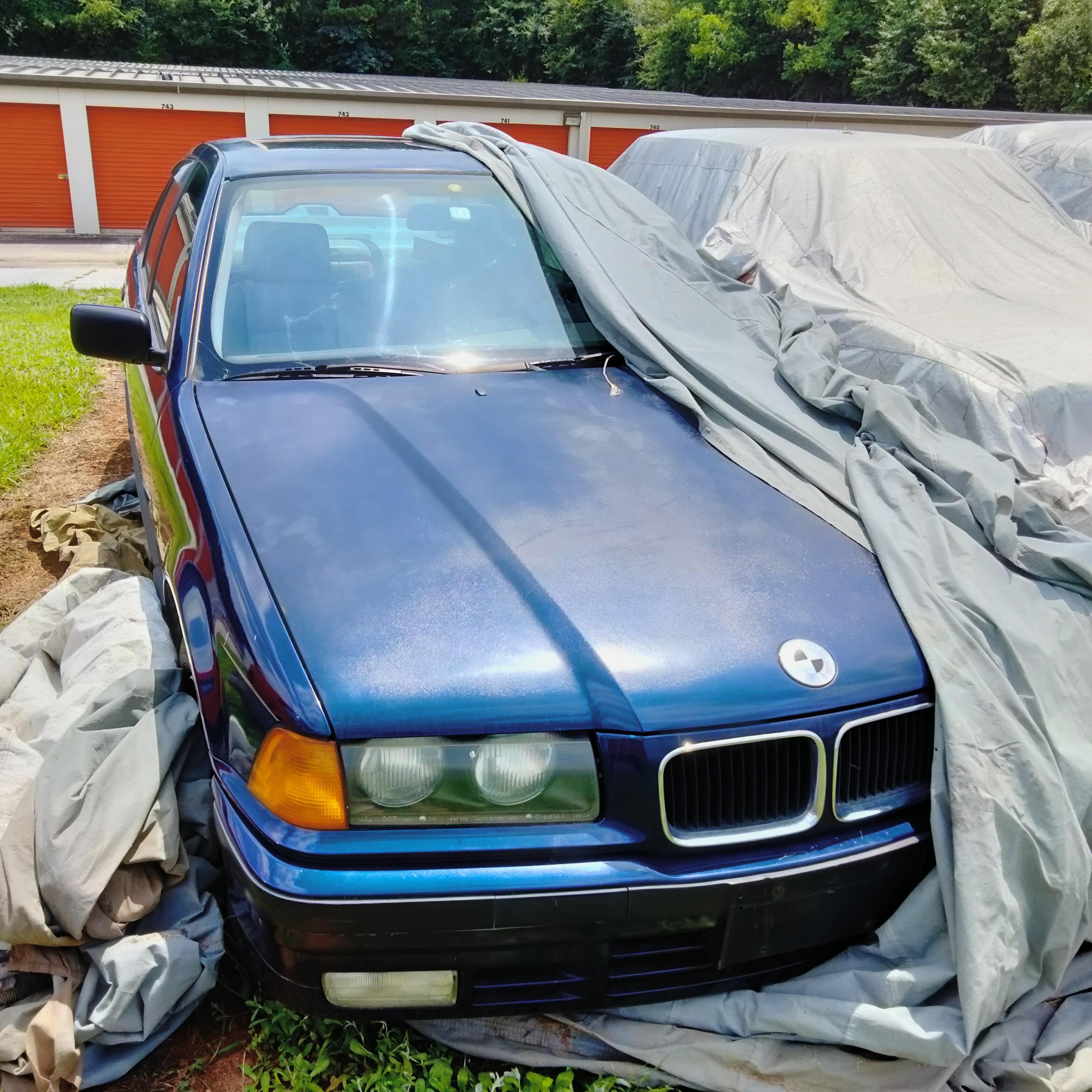

A couple days I decided to replace the 2 airbag crash sensors on my '92 BMW E36. I assumed that a couple of used, but cleaner, 2 sensors, would be better than the old ones with black tar coming out. My '92 engine is the best ever, five speed, and I have been doing most of my maintenance. After a short trip, 5 miles, in the dark. First came the instrument panel go dead except for the mileage numbers. It seemed to be OK but I locked the doors. In the morning, the key wouldn't open any door except for the trunk lid. I thought it was a bad battery and I put a charged one in. That didn't help. I didn't consider the fact that the one or two of the crash sensors might have come from an E36 wrecked car. Do I cut away a big hole in the hood, above the locking cable? Should I put the old ones back in? I have no way to open the doors. I think that is a rotten deal, to cause all this trouble for the owner. Any ideas? The crash sensor is next to the right/left front strut towers.
This is my only '92 photo that is already in my home computer. I have another '92 also, I'm afraid that it will do the same if I drive it. I have 6 other cars: An '87 BMW 528E, '95 BMW 325i., '96 328ic. The other 3 are EU.
