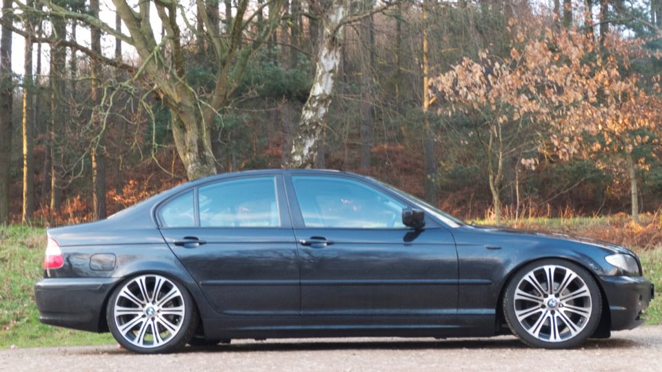

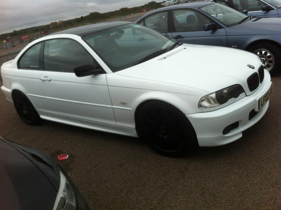

It would seem that way. Although I bet that the local law will still single me out. That car is nice, why did you get rid of it? :). I am considering raising the back a shade, I saw in Halfords they sell a gadget to make it a tad higher, by putting rubber strips in between the coils on the spring. I might try it. I don't know how to make my picture any bigger. Sorry :S
Ah that's pretty. I really like the look of those. Are you gonna keep that one? Makes mine look like a right Sh***er. Well ATM it is but I'm getting there lol. A friend of mine is selling a nice white 5 series (I think it's a 5 series), for only 900 nicker. It's tempting but I've poured too much money into this Tardis to waste it on another one. A nice respray and it will be right as rain :)
