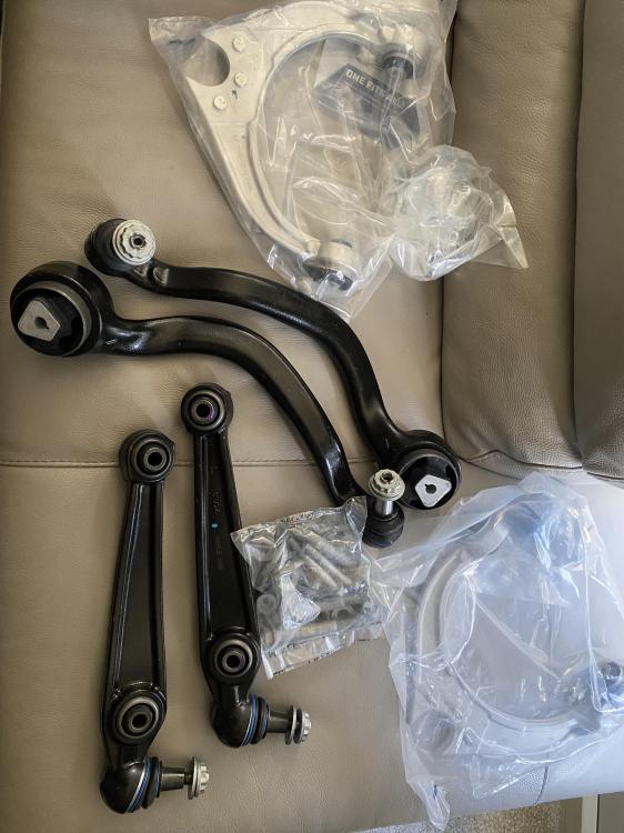

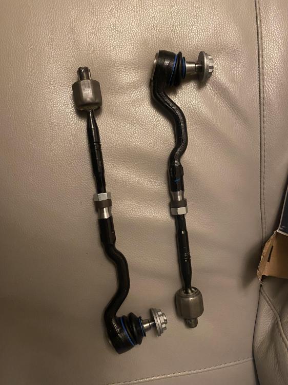

Also received these yesterday. Just under £500 for the tie rods and front links, and £540 for the front bearings. Will get the rears in a few weeks, and tie rods and anti roll bar bushes.
Morning Gary
The upper wishbones are a bit of a fiddle but the rest is straight forward the rest is straight forward. I use new mounting bolts for the lower arms and make sure the suspension is under load before final torqueing
My E70 took around 2hrs a side (including Tea and Biscuits) and that's in my Home Garage without a lift (just get the car as high as you can) The 4 wheel alignment afterwards was £90 at my local Garage I use for MOT's (2 years ago) So a £1000 seems a bit OTT unless he was supplying parts as well
