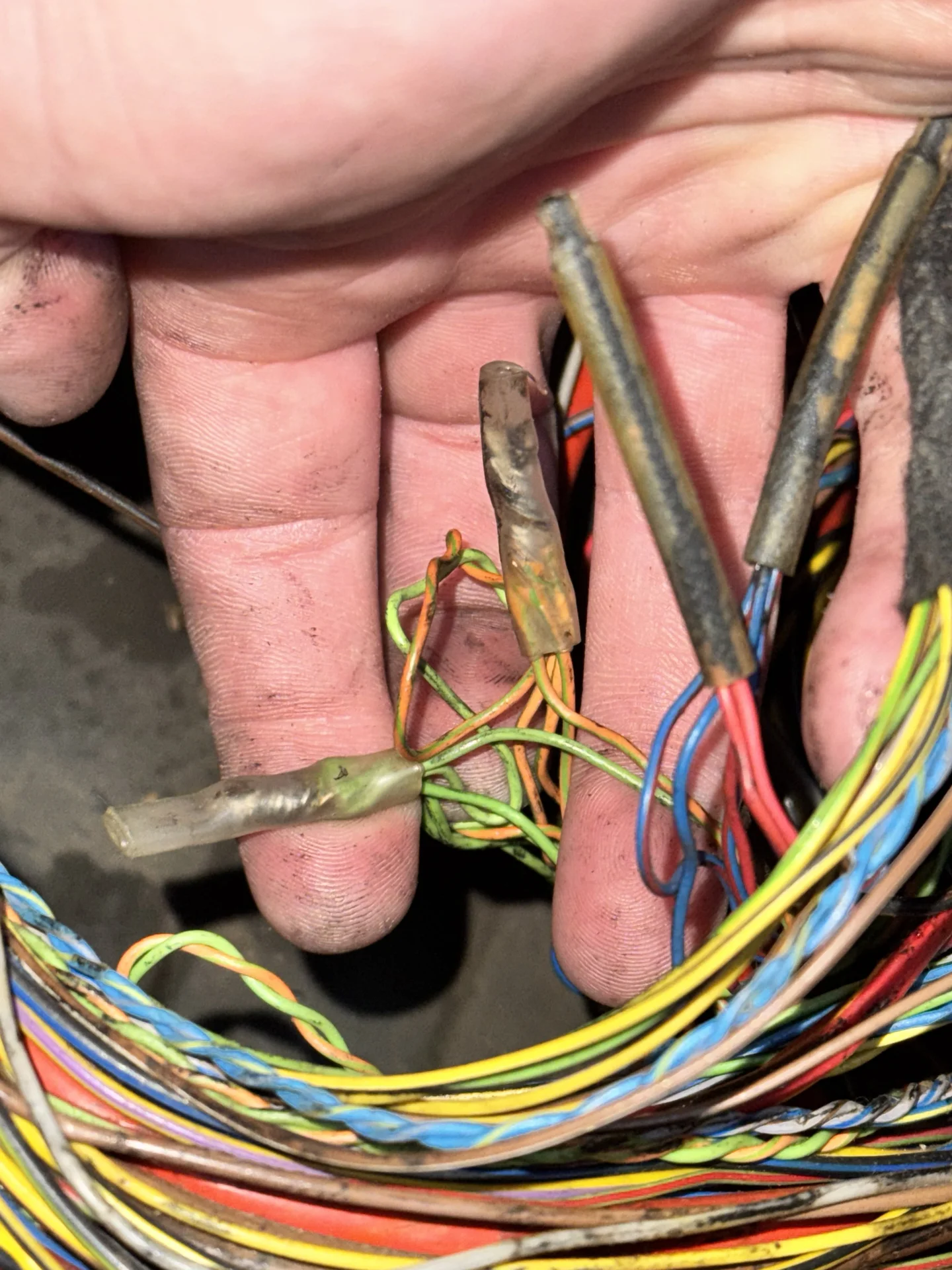

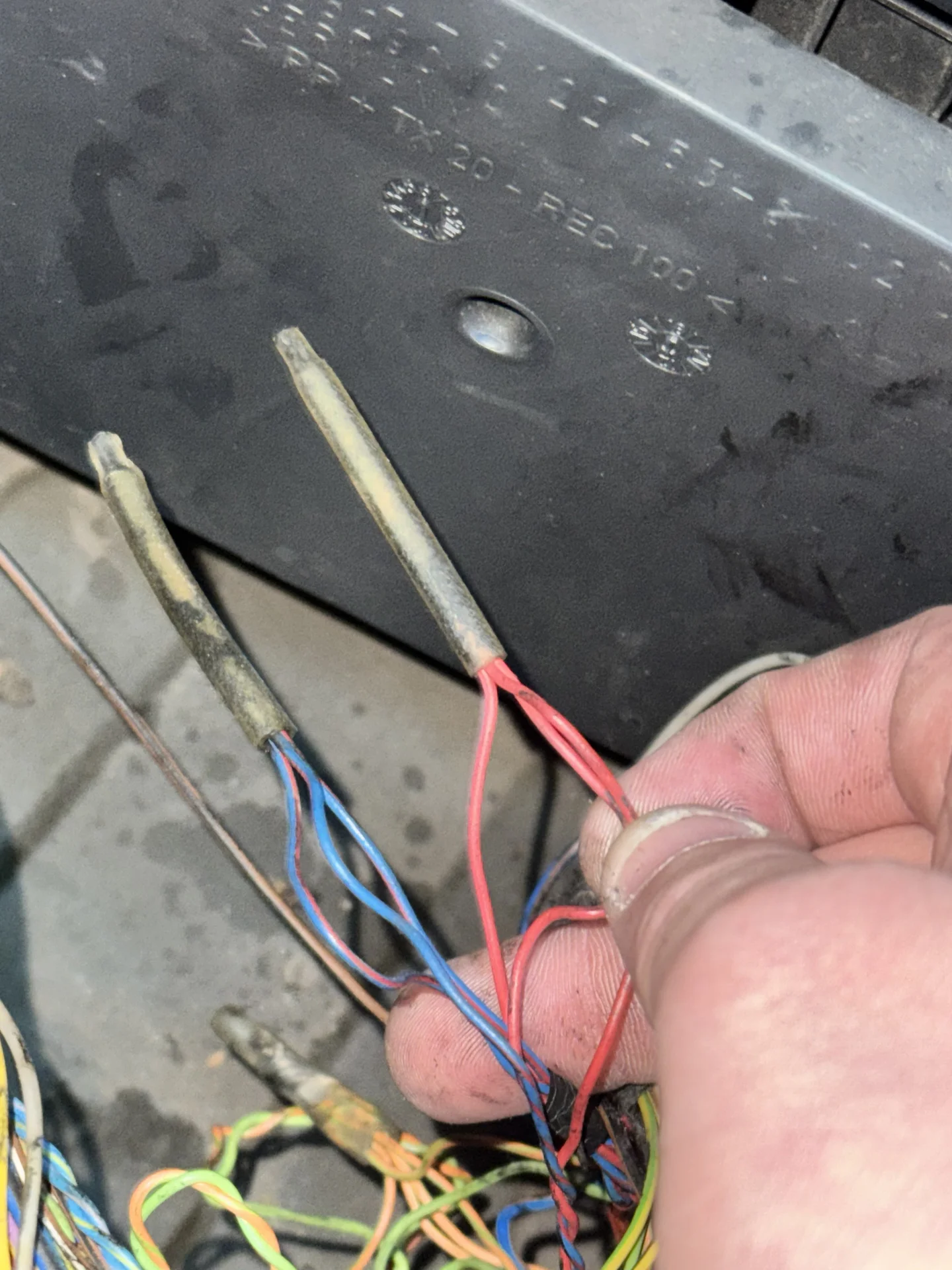

my own X5 E70 had several K-can bus issues which after a lot of head scratching lead me to a BMW cable jointing system common on our cars. The joints are not soldered they are twisted and compressed then covered in a clear plastic sleeve. As you have suffered water ingress I would start in the Boot/Trunk under the floor starting at the rear right below the rear fuse board you will find the main Loom it runs along the rear of the car towards the battery hidden in it are several of these joints (pictures attached) The dark stain inside the clear plastic is corrosion with my car several of these joints just fell apart. I ended up remaking and soldering all the joints in the pictures the sealing them with shrink wrap.
Once done I could clear all manner of faults that just wouldn't clear before. However as you are also having other issues they may possibly be either junction box and/or footwell module related. Also check the alternator output it may be the voltage regulator is fritzed
