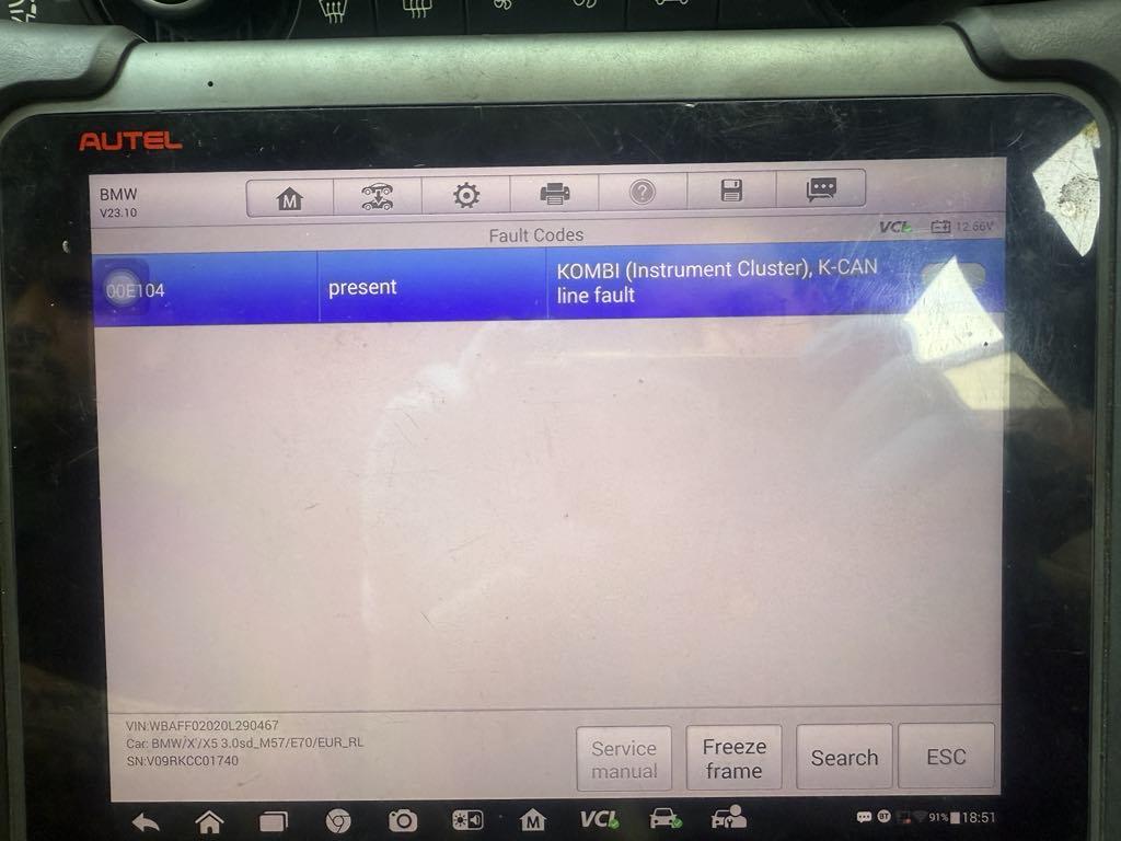

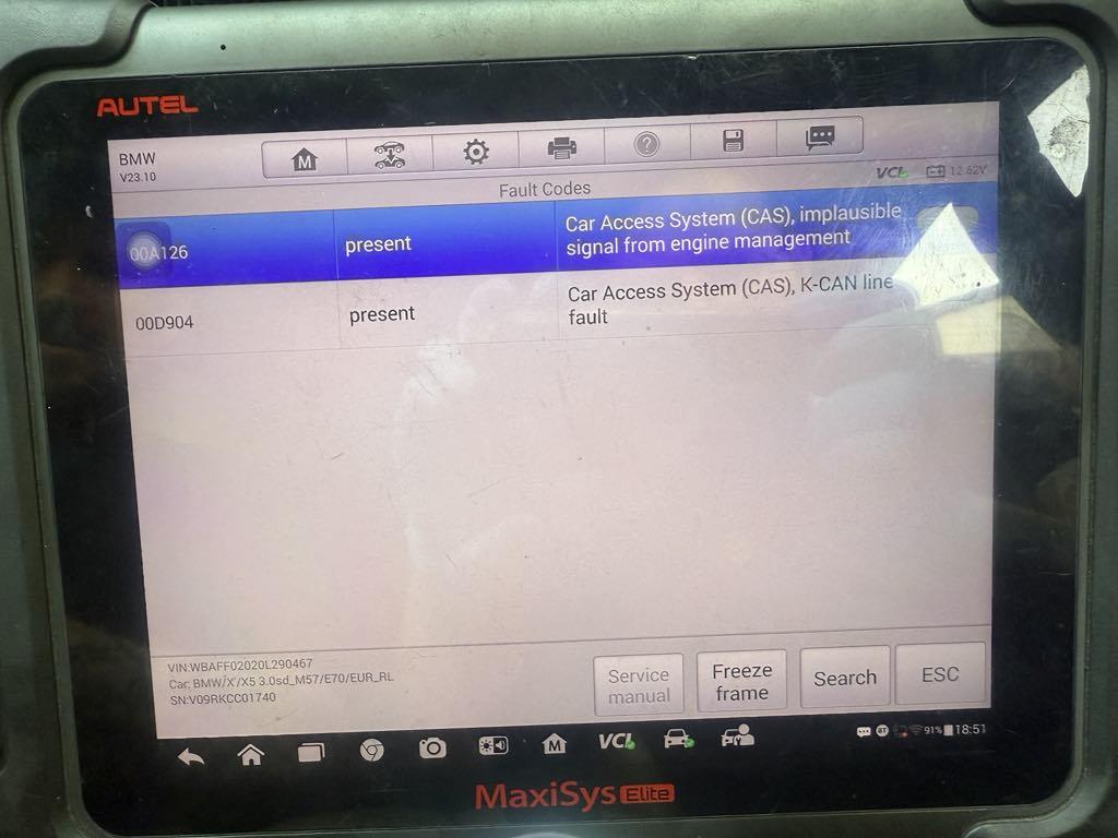

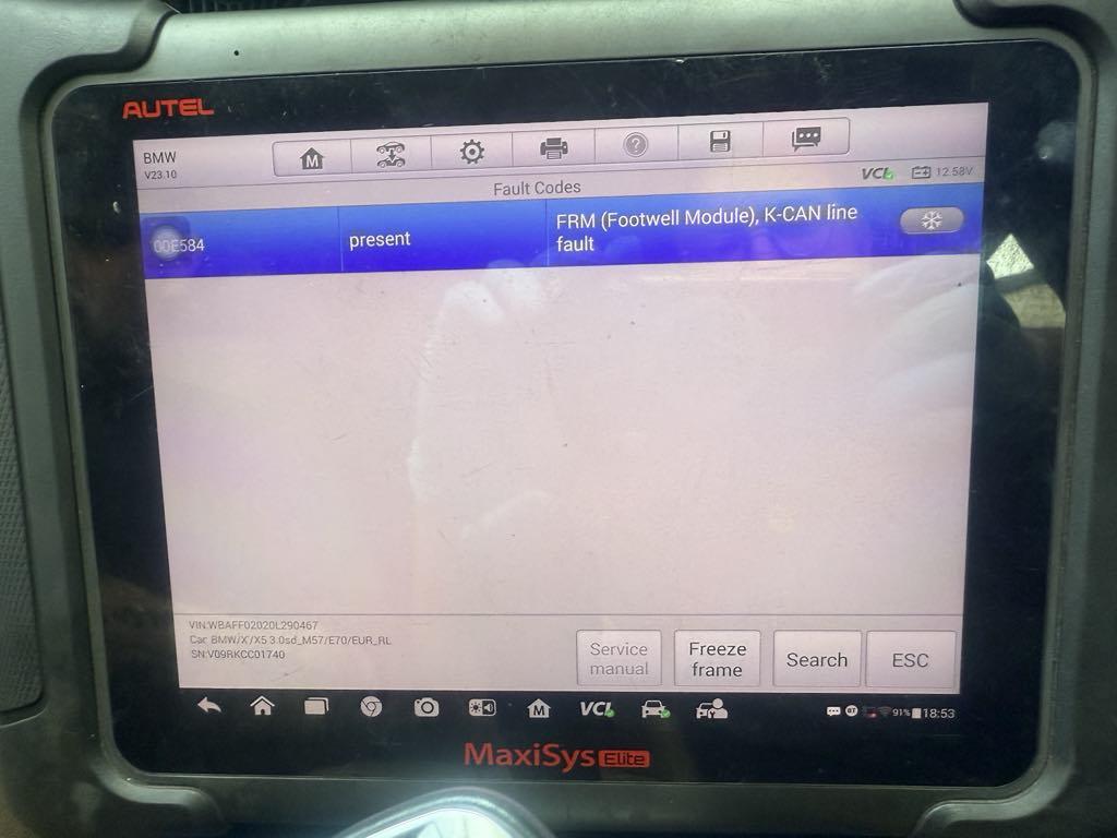

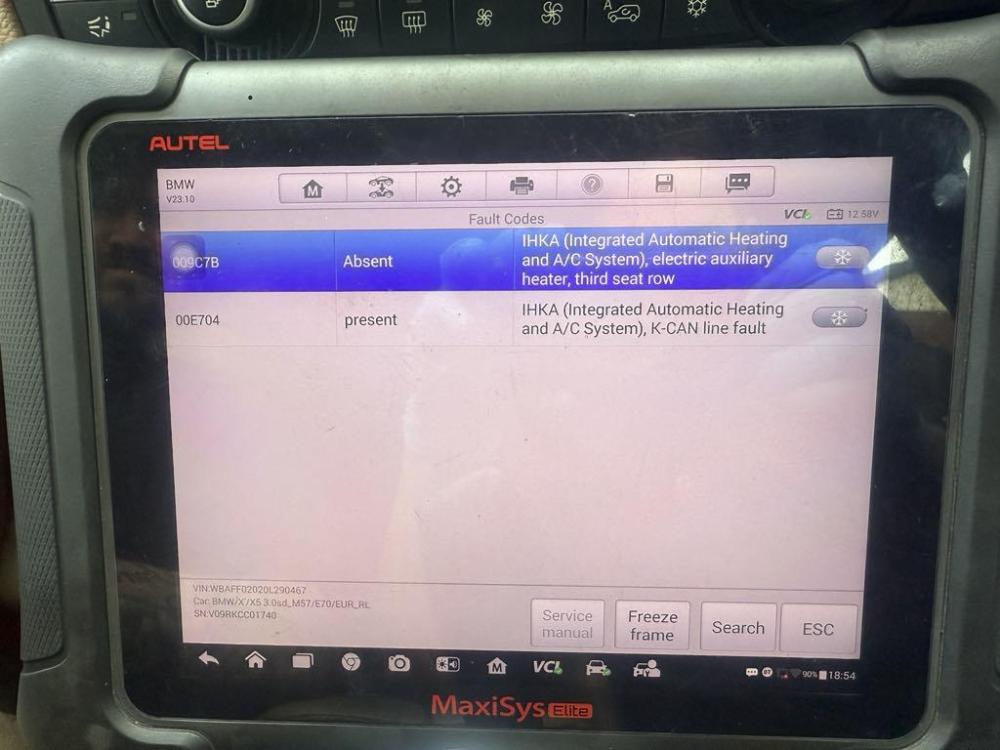

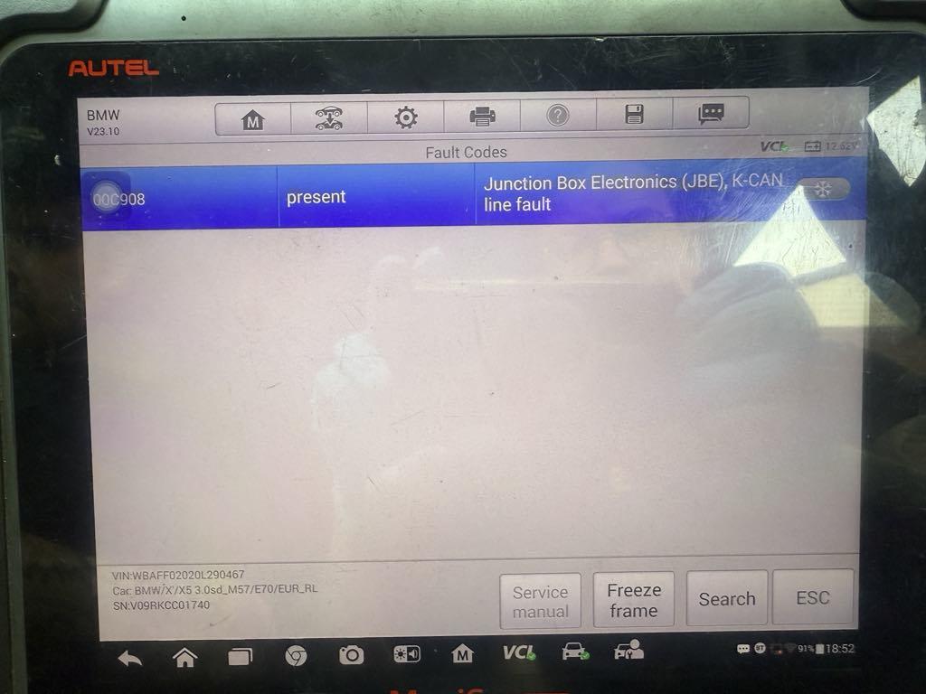

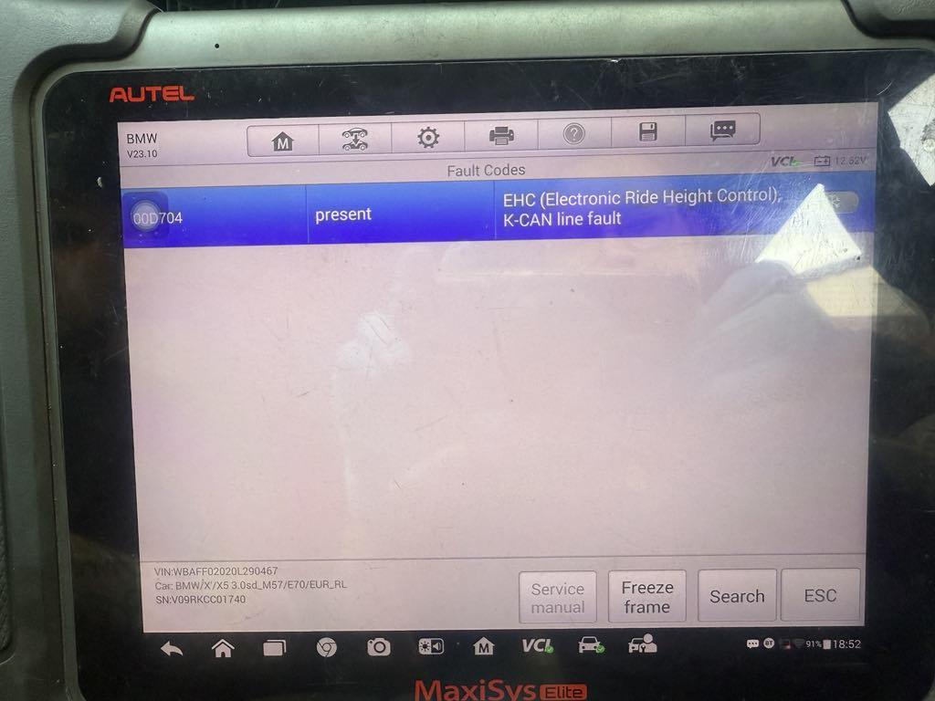

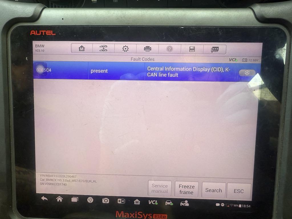

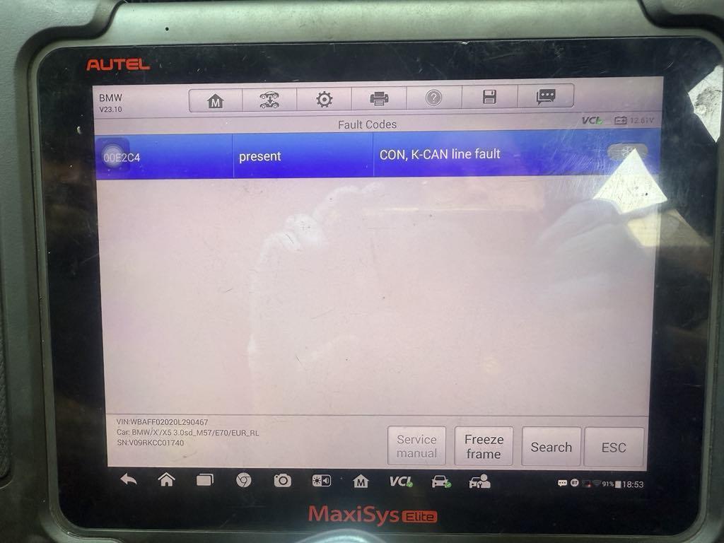

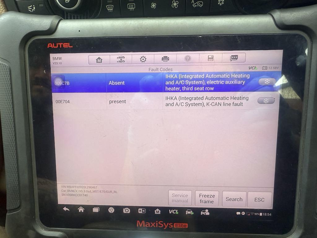

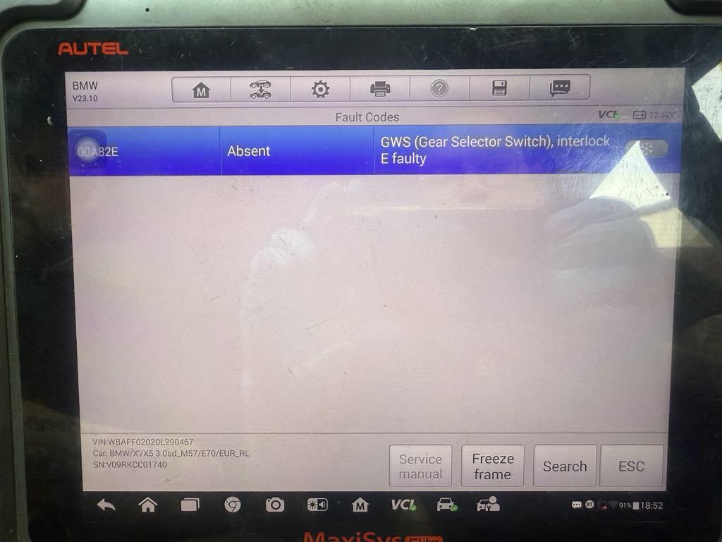

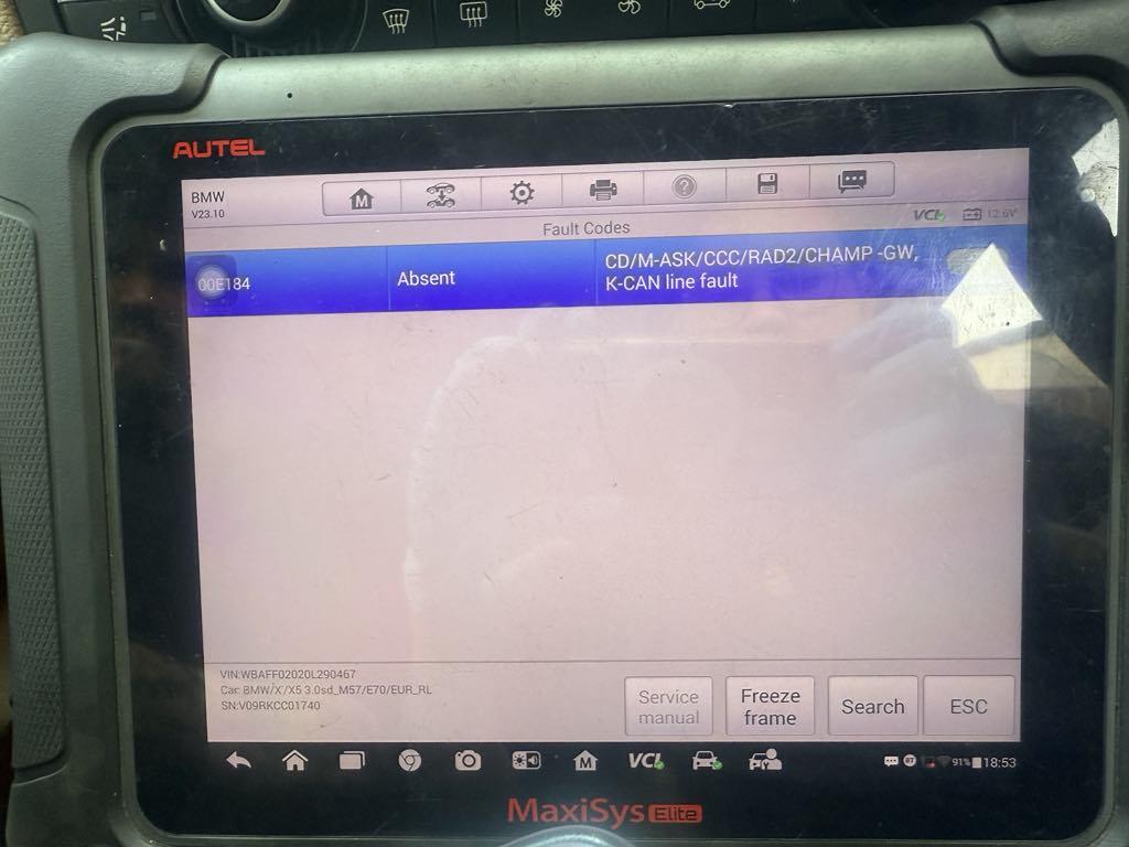

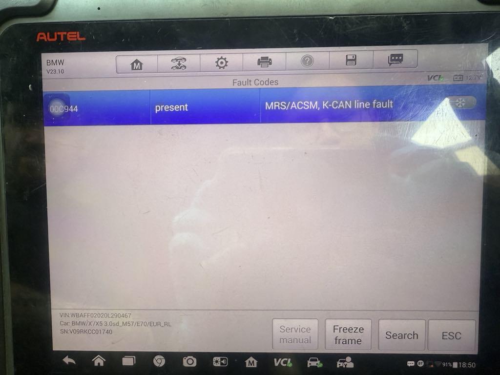

Thanks Dave these are the codes that are coming g up
Morning Steven
Plenty to go at there 🤣
I see that most of the fault codes are K-can based, if your not aware the Bus system is how all the Control modules talk to each other, so first port of call is sort the K-can bus fault. That should allow you to clear most of the faults then we can see what is left

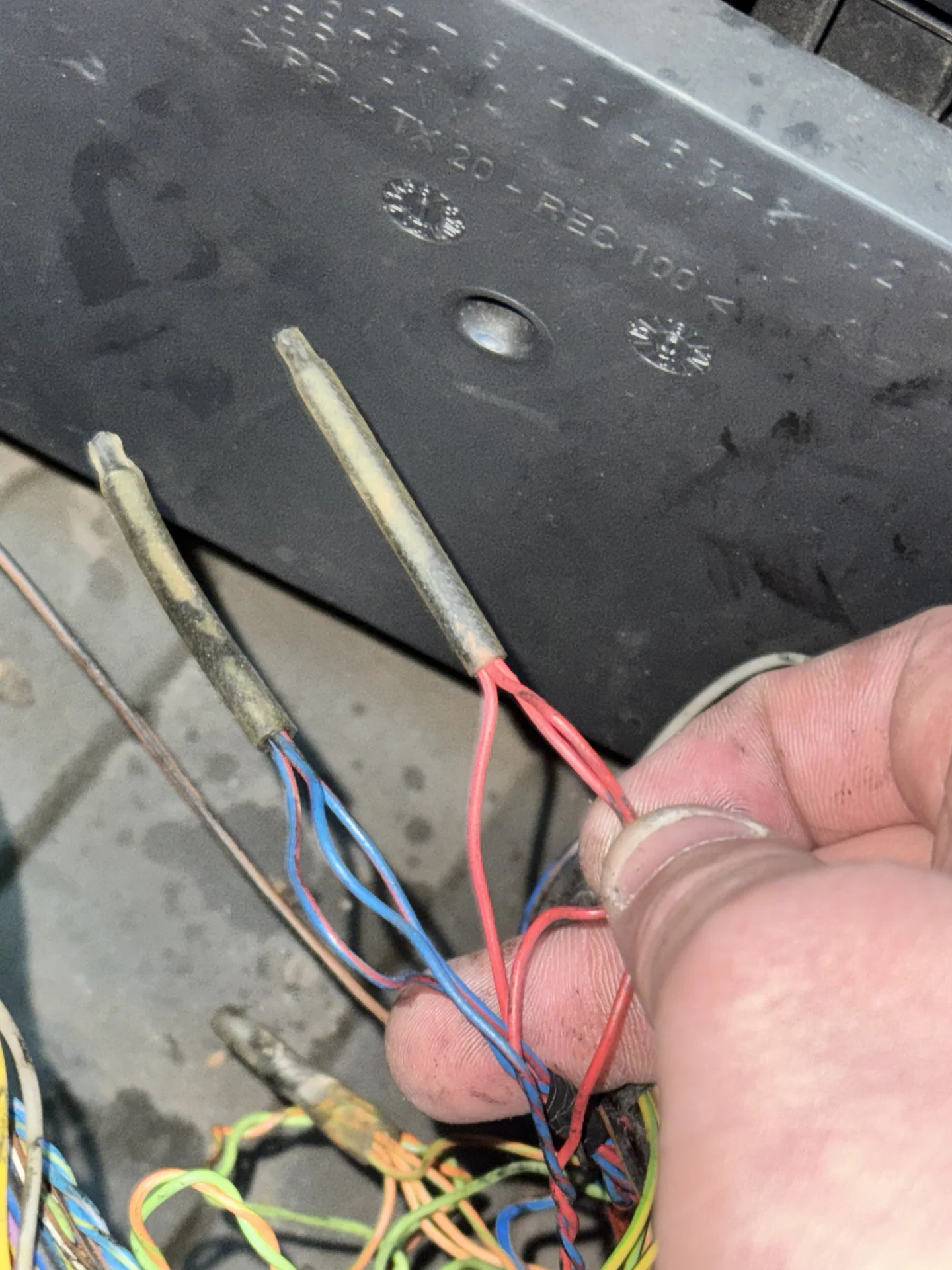

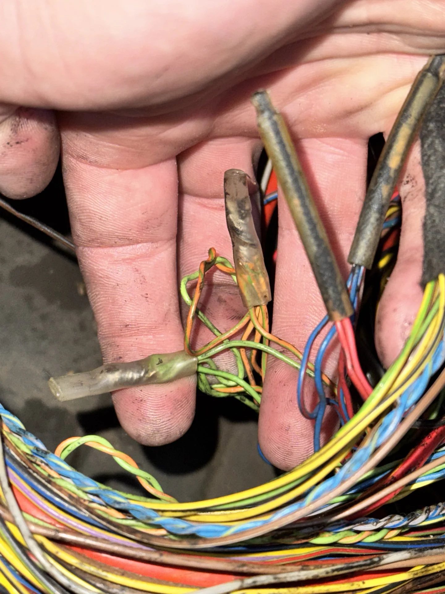

So it may be simpler than you think and not as scary, in the boot right hand side you will need to take out the battery cover and storage box (5 screws). Take out the cover for the rear Fuse Board (unclips) and remove the small storage tray under it (2 push clips) Now you will have access to the main loom across the back of the car. BMW in their wisdom decided to make solder free cable joints by twisting and compressing joints then putting a clear rubber/plastic seal over them. Moisture gets in and the joints corrode and fail that is the cause of your problem, now the fix.
Tools you will need are, Soldering Iron and solder (my preference) or a method of jointing the cables plus some shrink wrap/tape to seal the joints
You need to dig into the main loom the runs below the fuse board where it begins to rise and across the back of the car
The Pictures show what your looking for any black in the clear plastic is corrosion, when I found mine and moved the joints for the K-can bus they literally fell apart. Look at the picture (Cable splices) you can see the 2 smaller splices on the left (Orange/Green trace and Green) that's the Can Bus. I took off the clear plastic (it fell off) stripped the cables back twisted the cables together and soldered the joint. Work one joint at a time so nothing gets mixed up, once the Can Bus is fixed you should be able to clear most faults. When I found this lot on my E70 I remade all the joints one at a time just for my own peace of mind all of them are in the big loom below the fuse board and across the rear of the car towards the battery.
Not a scary as it seems, when done and tested tidy up the loom with some tape and put everything back together

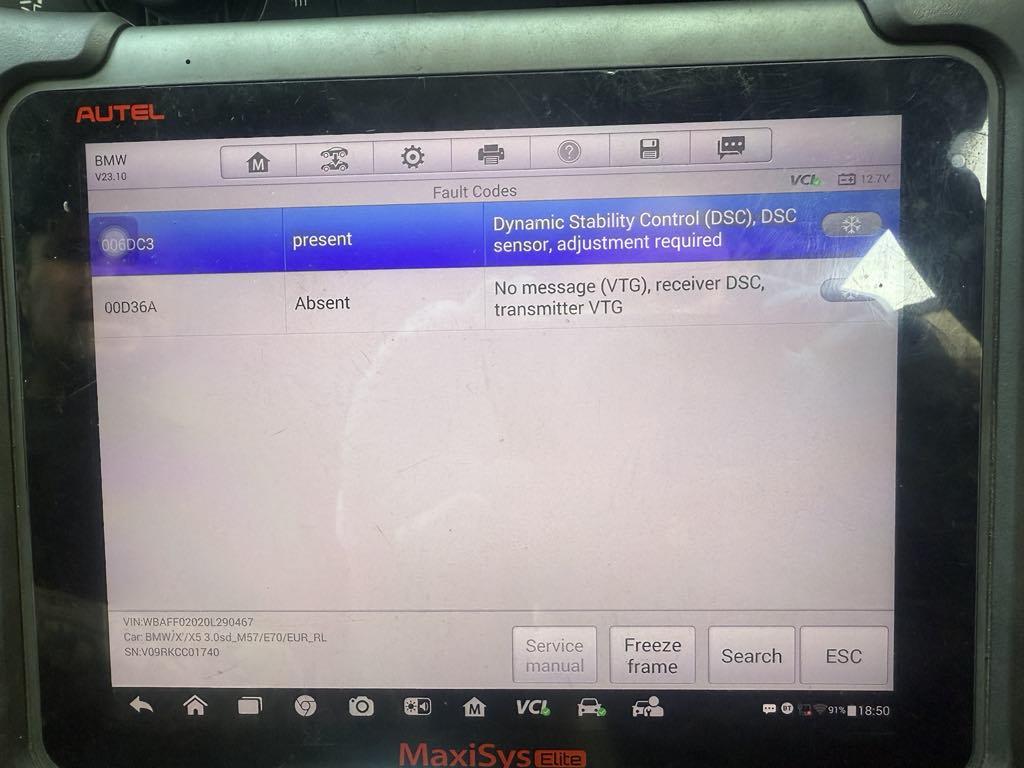

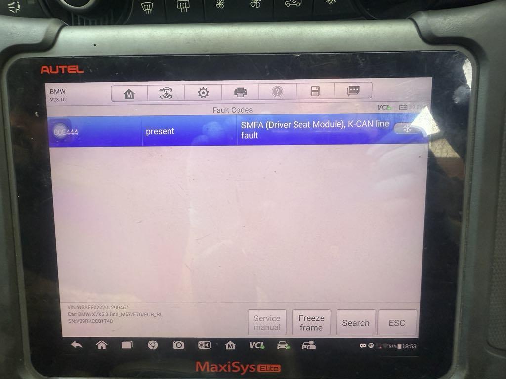

Thank u so much for your time Dave I managed to get someone to plug in with bmw diagnostic and they said they narrowed it down to the transfer control case module il check these cables thou aswel
Morning Steven
Really ? your screen shot doesn't show any VTG Fault or is it a new one ? Or is it a different scan ?
You will need to either get them checked and repaired other wise the K-can bus faults will never be cleared and they will prevent some others being cleared. My course of action would be first repair the K-can Bus and clear down all the K-can Bus faults either using a Scan tool like your original screen shots or simply disconnect the Battery for 30mins (a Dealer Trick) Once that is done re-scan and see what faults show. Many folks have carried out costly replacement/repairs due to treating a symptom not the actual cause. Transfer Case damage/faults are normally tyre related  or the VTG oil needs replacing

Who ever you got the scan pictures from seems OK they clearly have Auto Logic software that can work with your car just depends on whether you feel comfortable with them I guess. Like i say first job is fix the K-can Bus show the post and pictures it will help the Garage or Mechanic get the job done without to much time wasting (£££) then you will be able to see what needs doing

That sounds fishy to me why would they order a Module without talking to you and showing the evidence? and when it doesn't clear the faults who pays for the part and the work?? Based on your pictures (where were they taken) as I say those don't show a Transfer case fault anywhere the code D36A is a communication fault with the DSC? What they do show a whole load of K-can faults (communication system) that is the place to start, get that fixed and the faults cleared. A couple of hours labour max. Then re=scan and you will see where the real issues are, then you can schedule any work, replacement parts etc.
