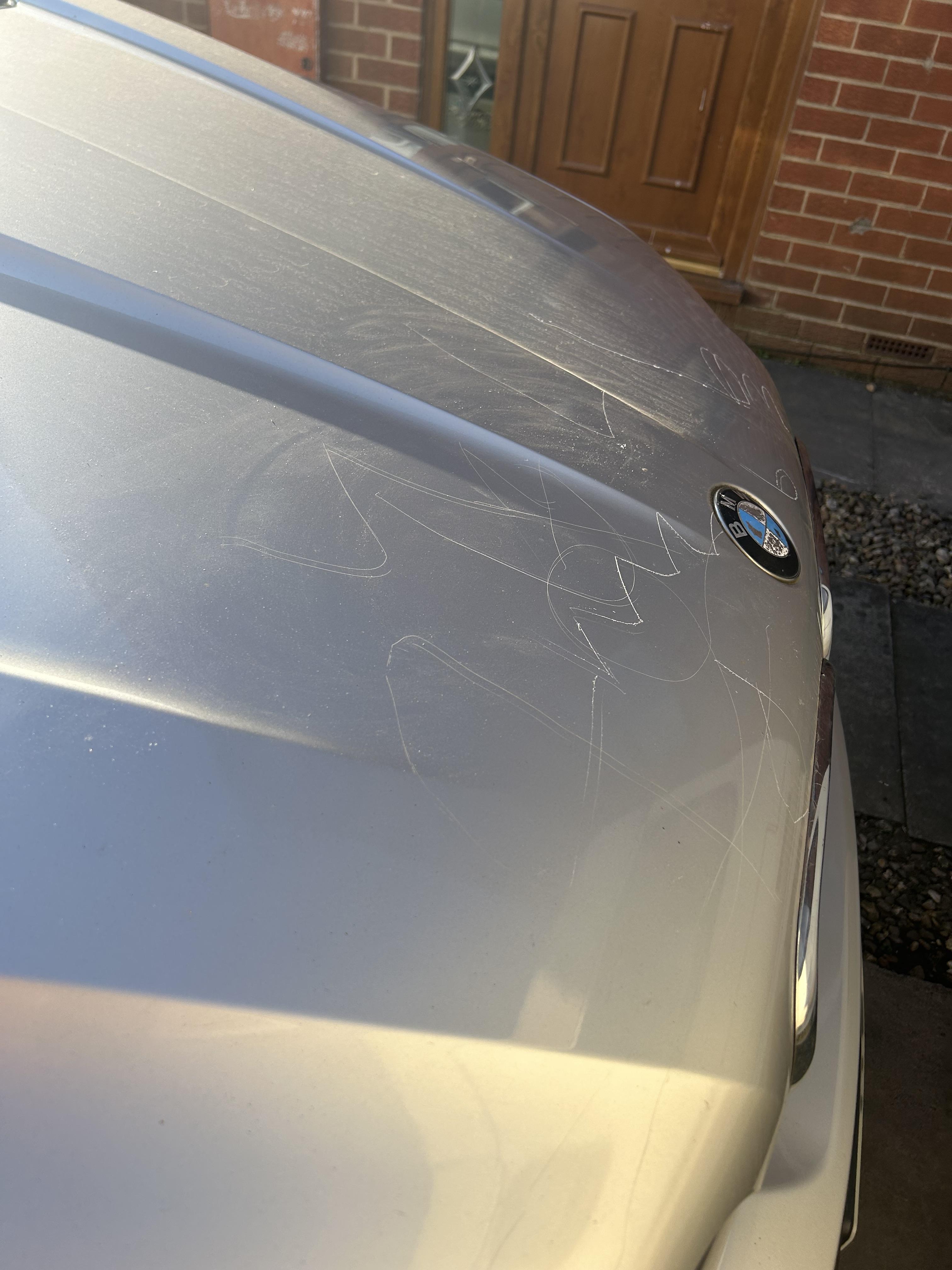

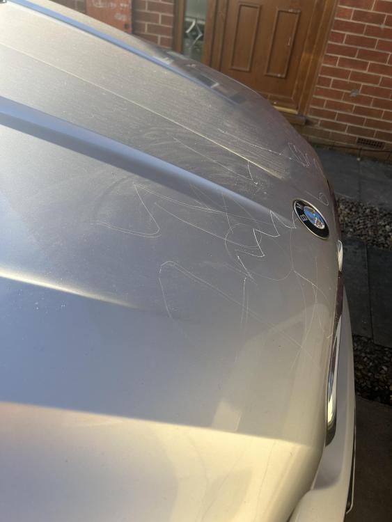

… decided he wanted to draw a robot….. on the x5…. With a drill bit!
needless to say, his mother is now talking to him upstairs very loudly!

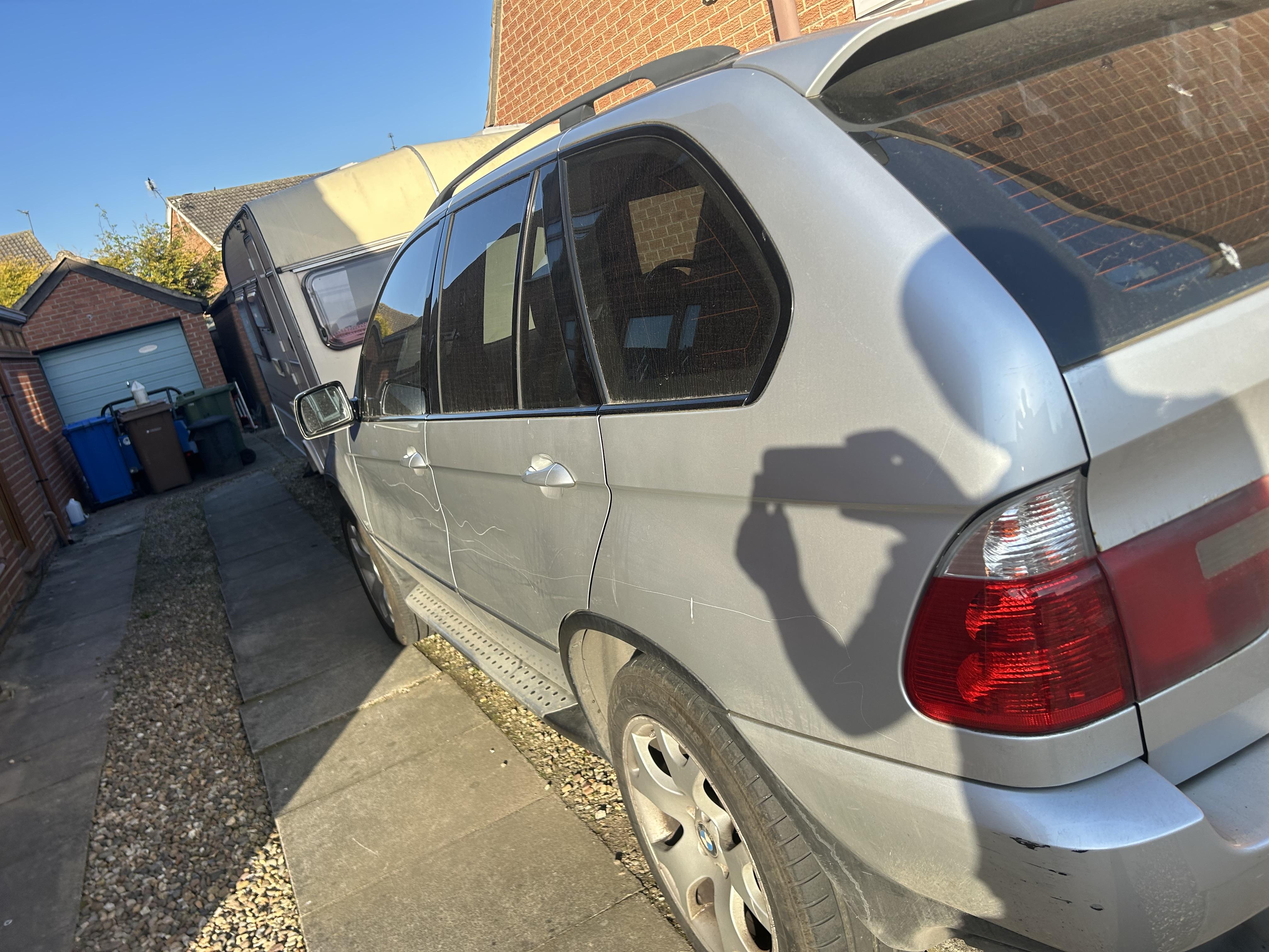

Fingers crossed most of it will cover up with a good polish 🤣

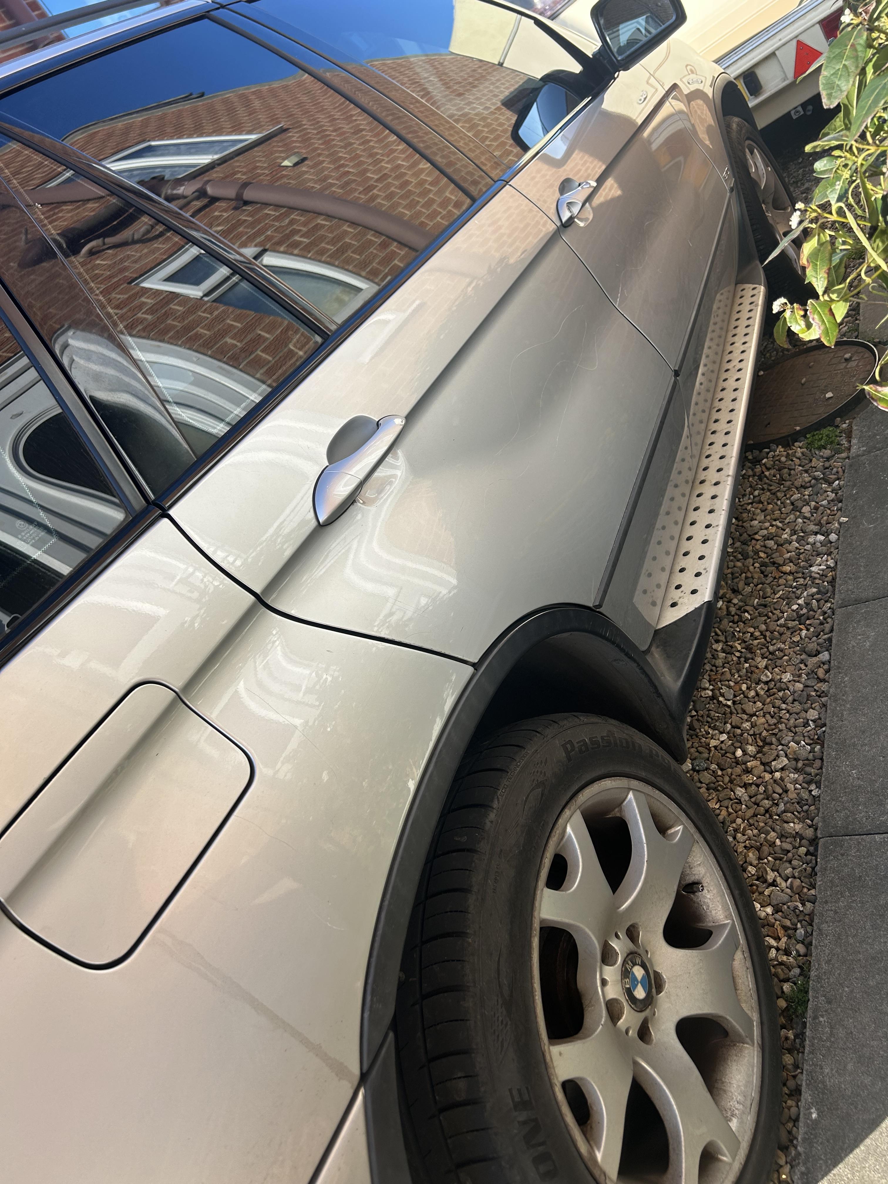

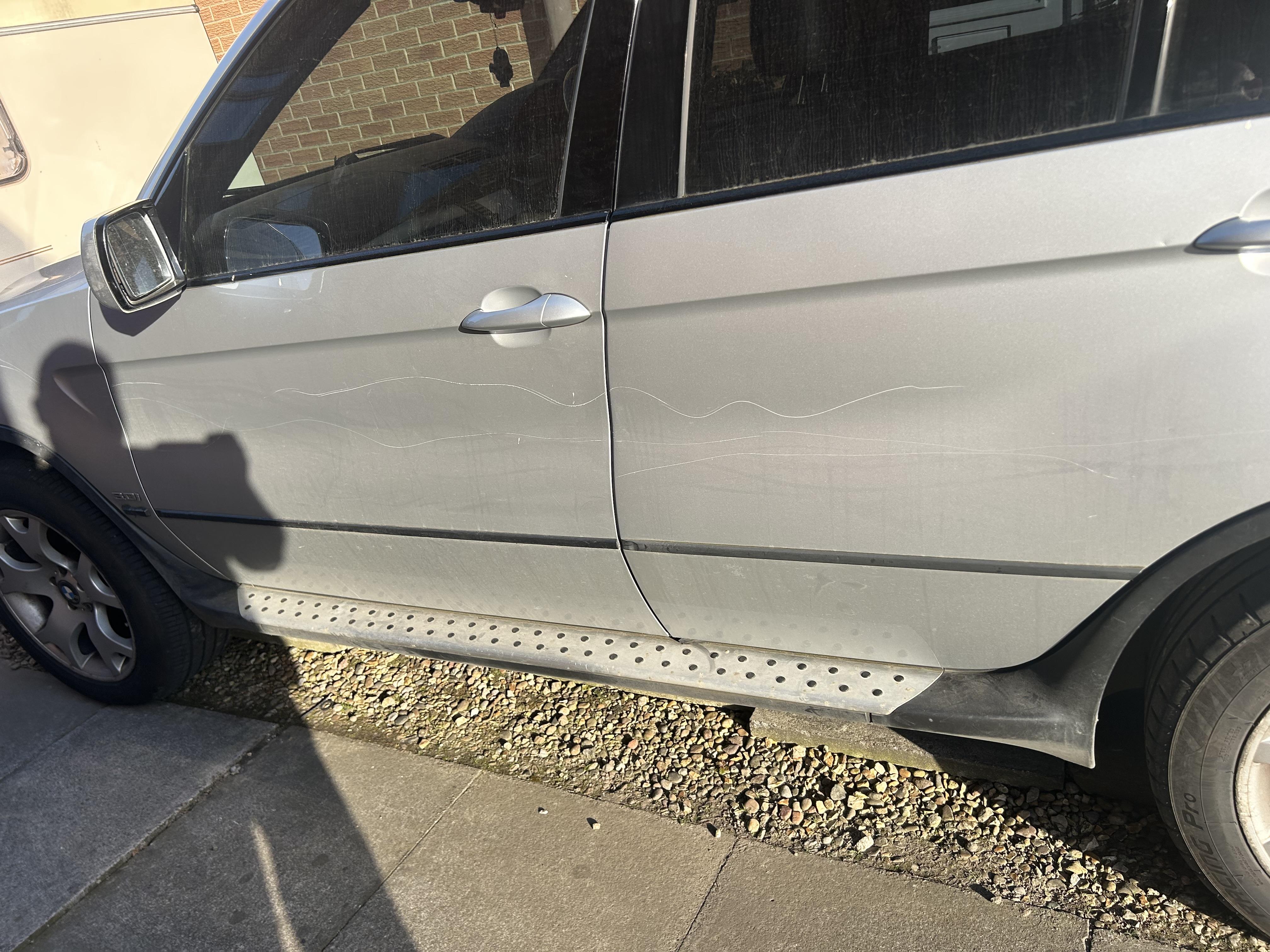

The doors should polish out with a good t cut and paint pen…. The bonnet is deeply scratched…

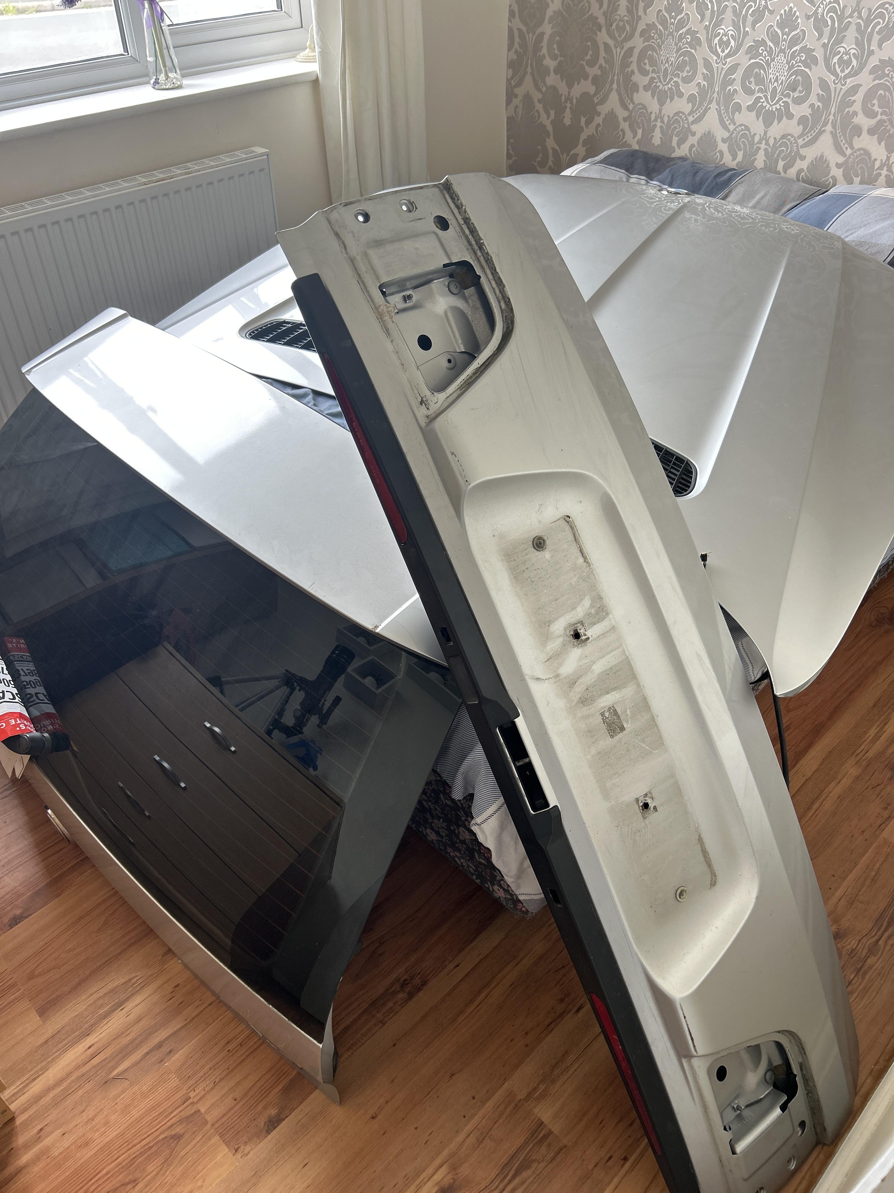

Update! … bonnet and boot sourced and awaiting delivery from a very nice guy who breaks BMWs… Tim at bmw classic spares in Northampton.
once they are on, I’ll set about polishing the whole car and try to hide the side scratches. It’ll be like a new un!

Well…. All the bits are swapped over, so I now have a pile of scratched panels on the driveway.

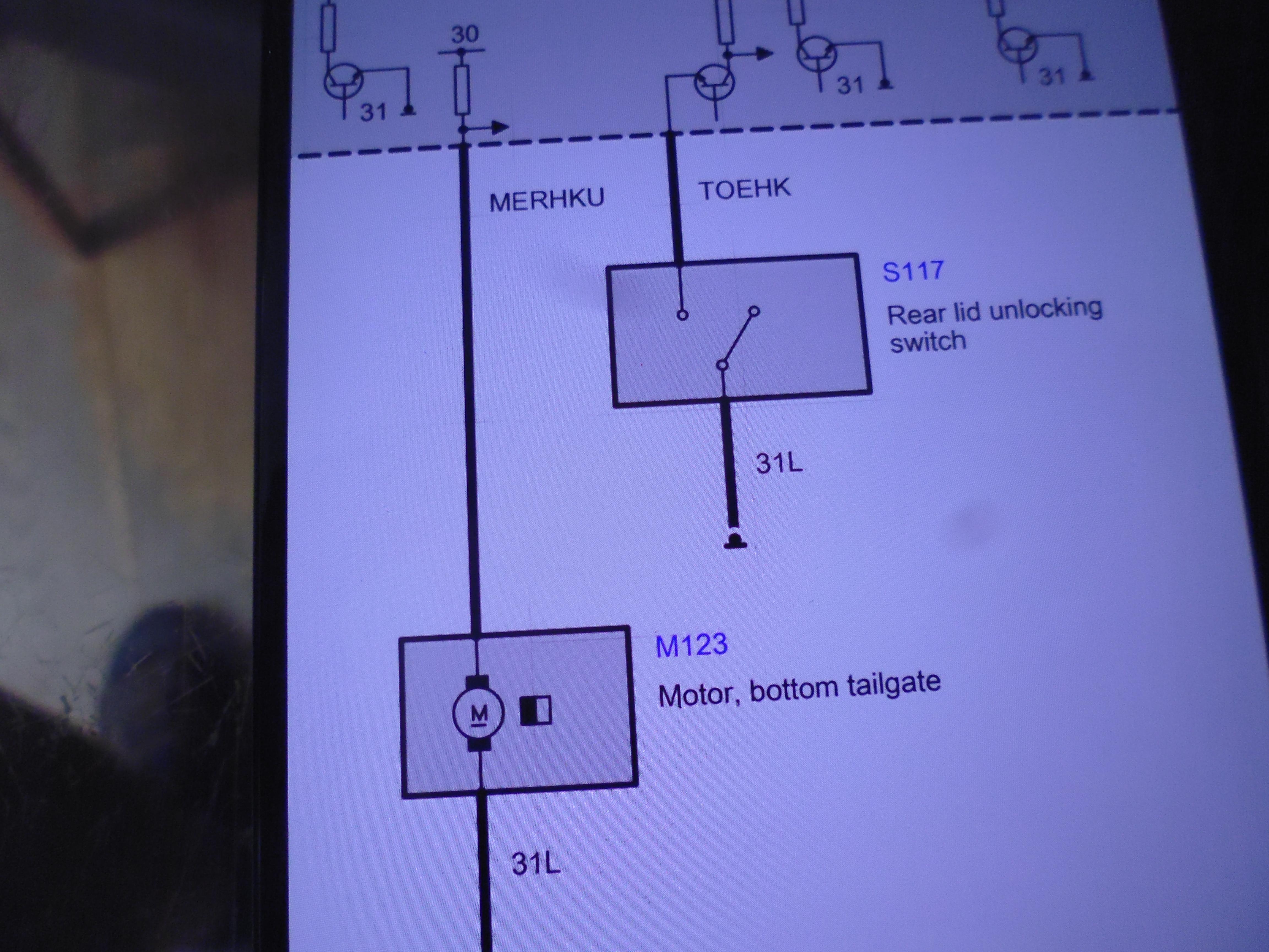

So very confusing while the Wiring Diagram shows the rear lower tailgate lock and actuator button it doesn't give wire colours (pictures attached) I checked the Bus system that didnt help either according to the wiring diagrams all pre-facelift models (up to 2004) should be the same
All I can think is either there is a short somewhere (through robber cable gromit at the top)
So not sure if it helps or not
Looked at the PDC and it points toward the PDC controller (in the boot down by the battery)
