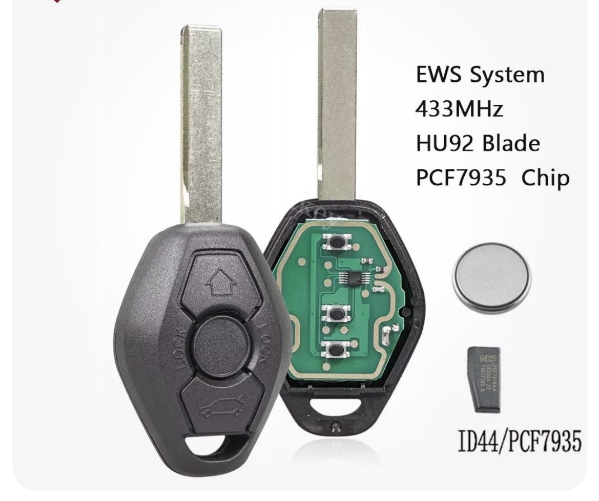

So I now have a key with a transponder chip *SEE PHOTO* (I assume the red bit) and I need to copy the code from the original key and copy it into the new one.
I did see a thing online but I don't know if it'll copy.
https://www.amazon.es/-/en/gp/product/B0DY7VCTQZ/ref=ox_sc_act_title_1?smid=A18I26BYARIXXP&psc=1

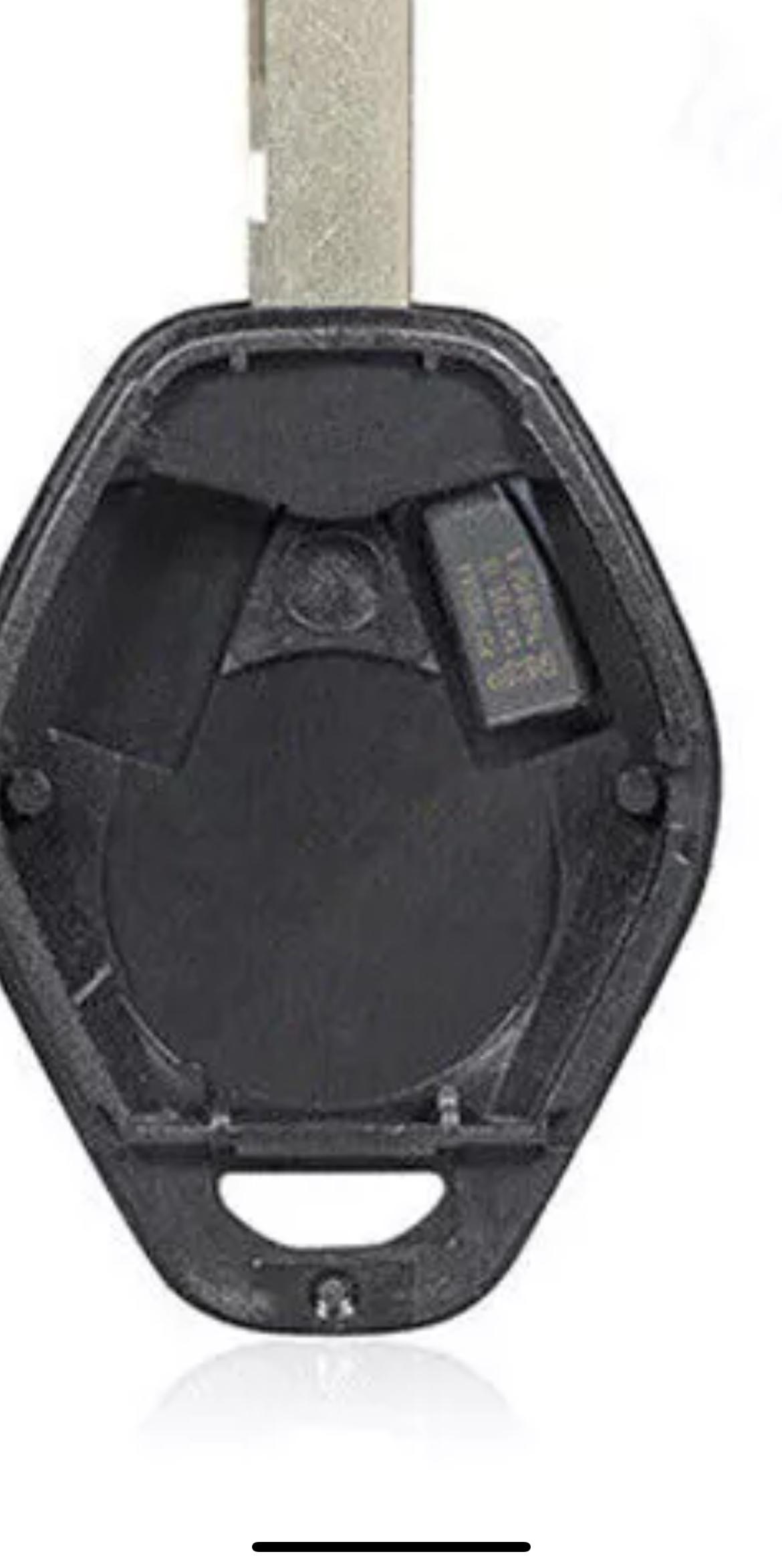

The chip can be seen on these pics and its location. This needs to be near the ignition barrel or it won’t be read.
the kit from Amazon worked well with mine. I’m sure you can only write to the chips and not rewrite, so it’s a one shot. I programmed it before getting it cut jut in case.
P.s… the original key might work if you change the battery. The door locks are not linked to the immobiliser or chip. The keys can be synced to the car doors once the battery is replaced.
