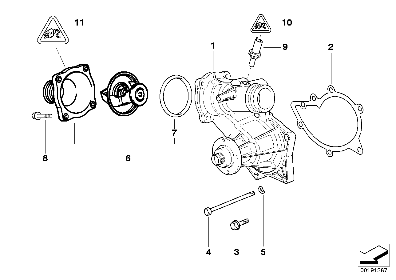

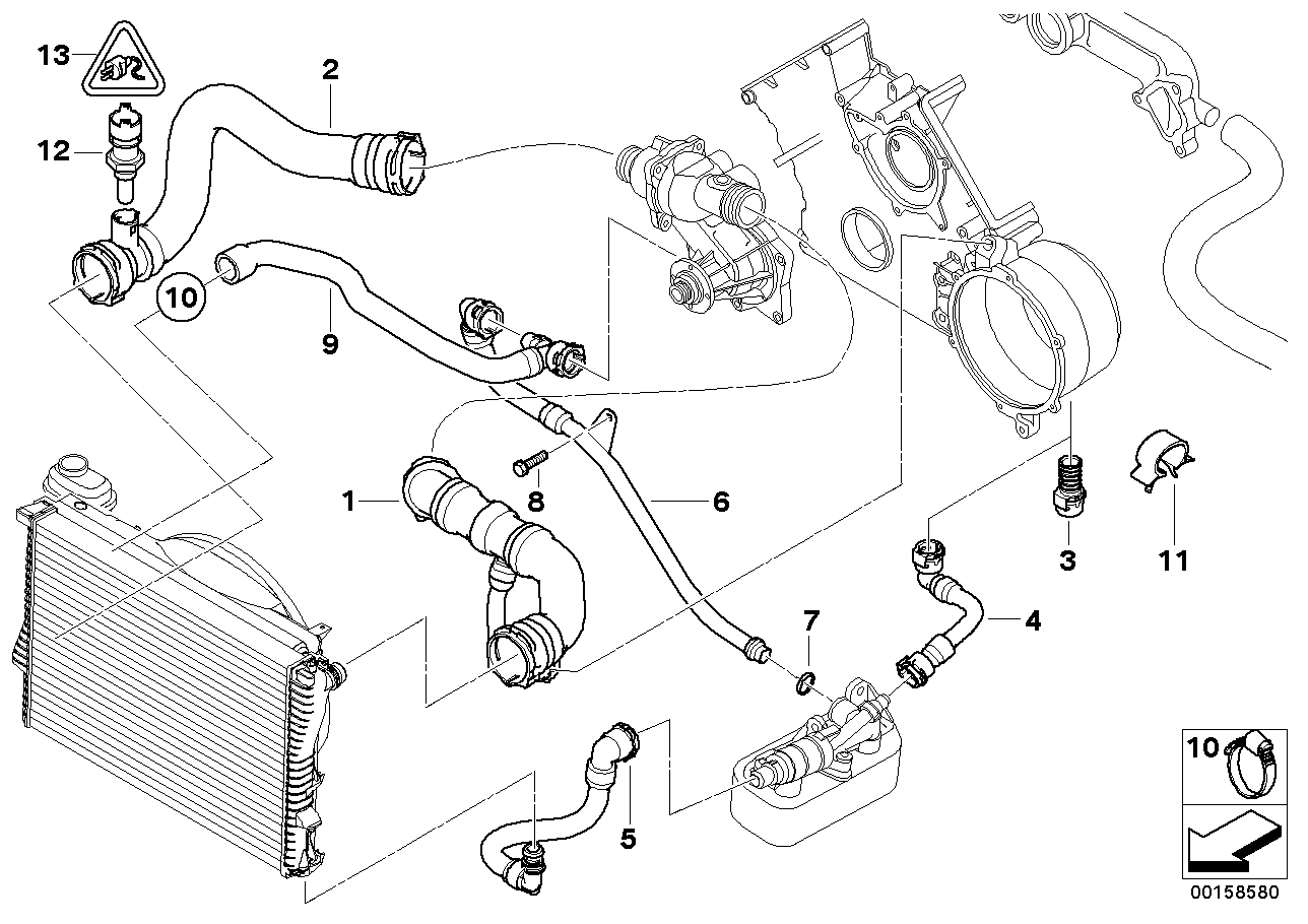

I have checked realoem and it gives me no temperature sensor option , which is strange. Also what I did was to remove the map thermostat and disconnected the resistance heating that is inside the thermostat and replace it with a 88C from an x5. Nothing else has been changed. The strange thing is that it run like that for 3 weeks in August.  When I start the car last week the temperature dial was going to max before dropping to normal value. And that happened only when cold. When warm the dial was showing the right temp. I also saw that the map for the thermostat was engaged when the car was running cold which made me think that there may be a connection between the thermostat dial and the map thermostat not being connected.
Not sure what engine your running but there should be a Temp sensor in the Hose from the Rad to the water pump then there should be  a Temp sensor in the housing for the Thermostat Both are shown in realoem for the 3.5 V8
I thought the V8 was the only one with dual use sensor on the Thermostat housing but stand to be corrected
You are absolutely right. The strange thing is that when I put the chassis number on the realoem it shows that the temp sensor is not applicable on my vehicle.  I will physically check for a sensor.

As I understand the wiring diagrams and operation Item 9 on the thermostat housing is the sensor which sends its signal to the ECU for interpretation with information from the map sensor. Information from item 12  (1st drawing ) is also used to provide average temp across the cooling system. As far as I am aware the Thermostst is independent of the sensors and operated by expanding wax material internally
