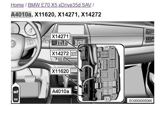

Hi, I have a problem with my 2011 X5 front parking sensors. I have used an OBD reader to check the failure codes and it appears all 4 front sensors have a ground or open circuit fault. I have checked the wiring harness for the front sensors and the main plug behind the bumper and all seem fine with no damage. I assume this must be the PDC module as it’s all the front not the odd sensor. But I cannot find it anywhere. can any one help please?
Morning Ken
Depending on exactly when your car was built the PDC location changed. According to ISTA cars built before late 2010 the PDC module is in the Boot below the fuse board. LCI models and 2011 on it seems it was integrated with the Junction Box Module which is below the fuse board under the Glove Box the smaller plug A4010a is the PDC connector

Great thank you Dave. I assume if I have continuity from this connector to the wiring behind the bumper then there is an issue with the JBE itself. Do you know if there is a module or anything on the JBE that could be in fault or am I looking at a complete replacement unit?
Hi Ken
Depending what OBD reader your using will either give Generic codes or if it is a fully BMW capable one then you should get better results (I use BMW ISTA/INPA)
First I would check near the front fuse panel on the side behind the trim you should find a Multiple Earth point (BMW love these) check it carefully they were a well known source of problems on the E53 and E70. If you have a wiring diagram it may help idntify which pins to check continuity on.
As far as I am aware the JBE with integrated PDC is just that it may mean a complete unit which will need coding to the chassis. Unless of course someone like ECU Testing (Derby I think) can fix it but that may put the car off the road for a few days
