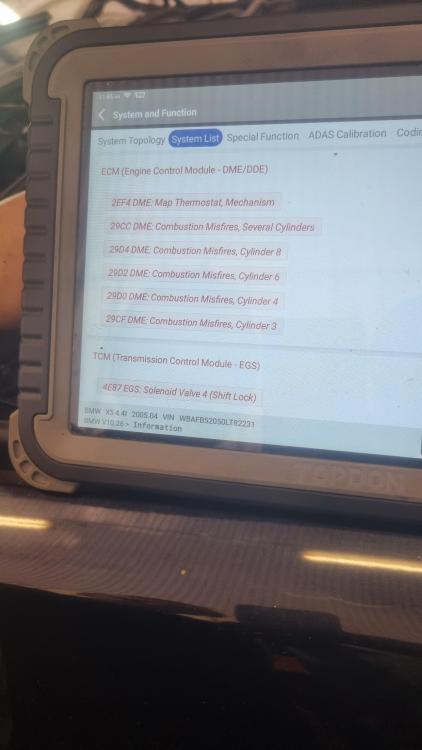

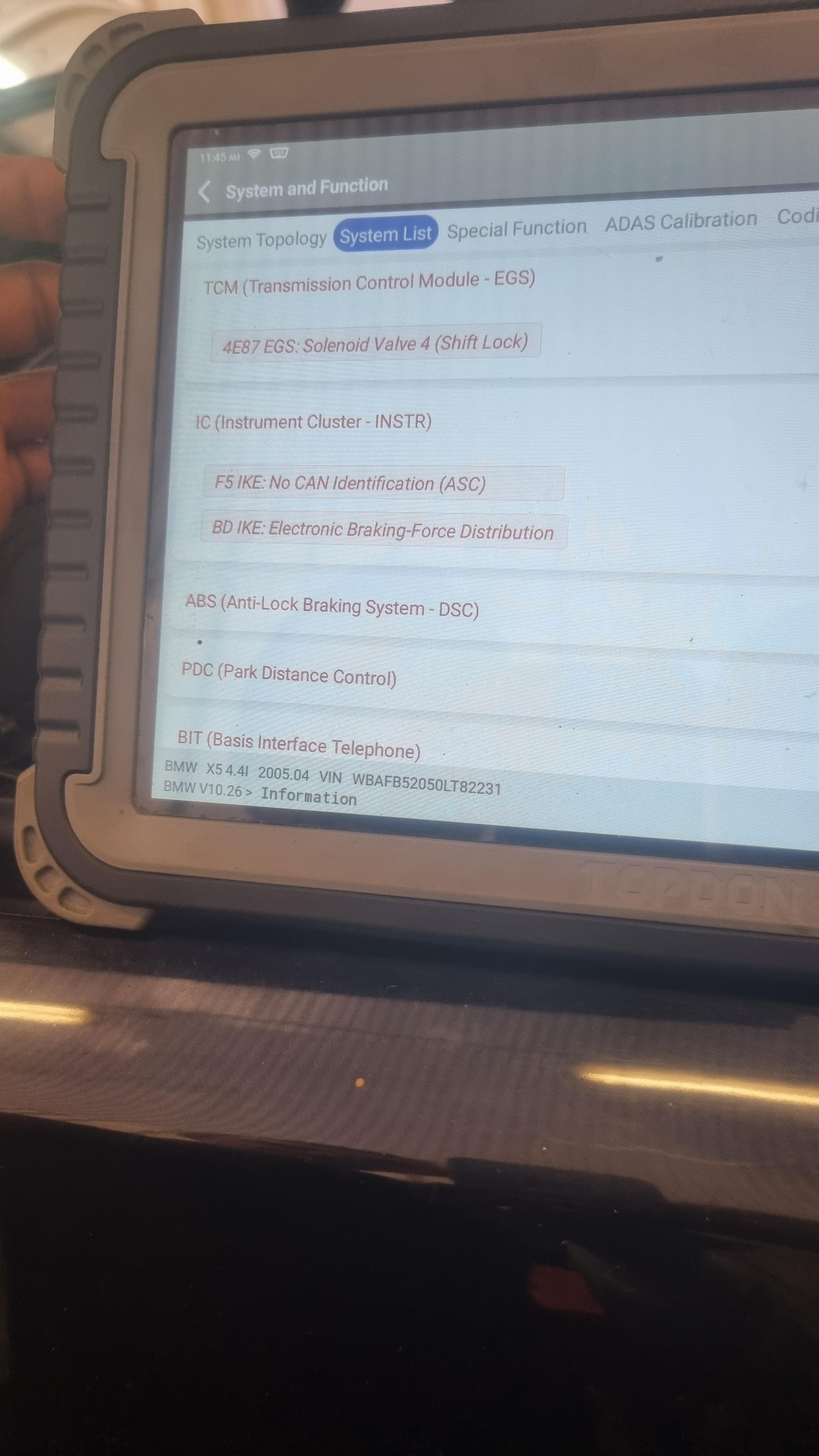

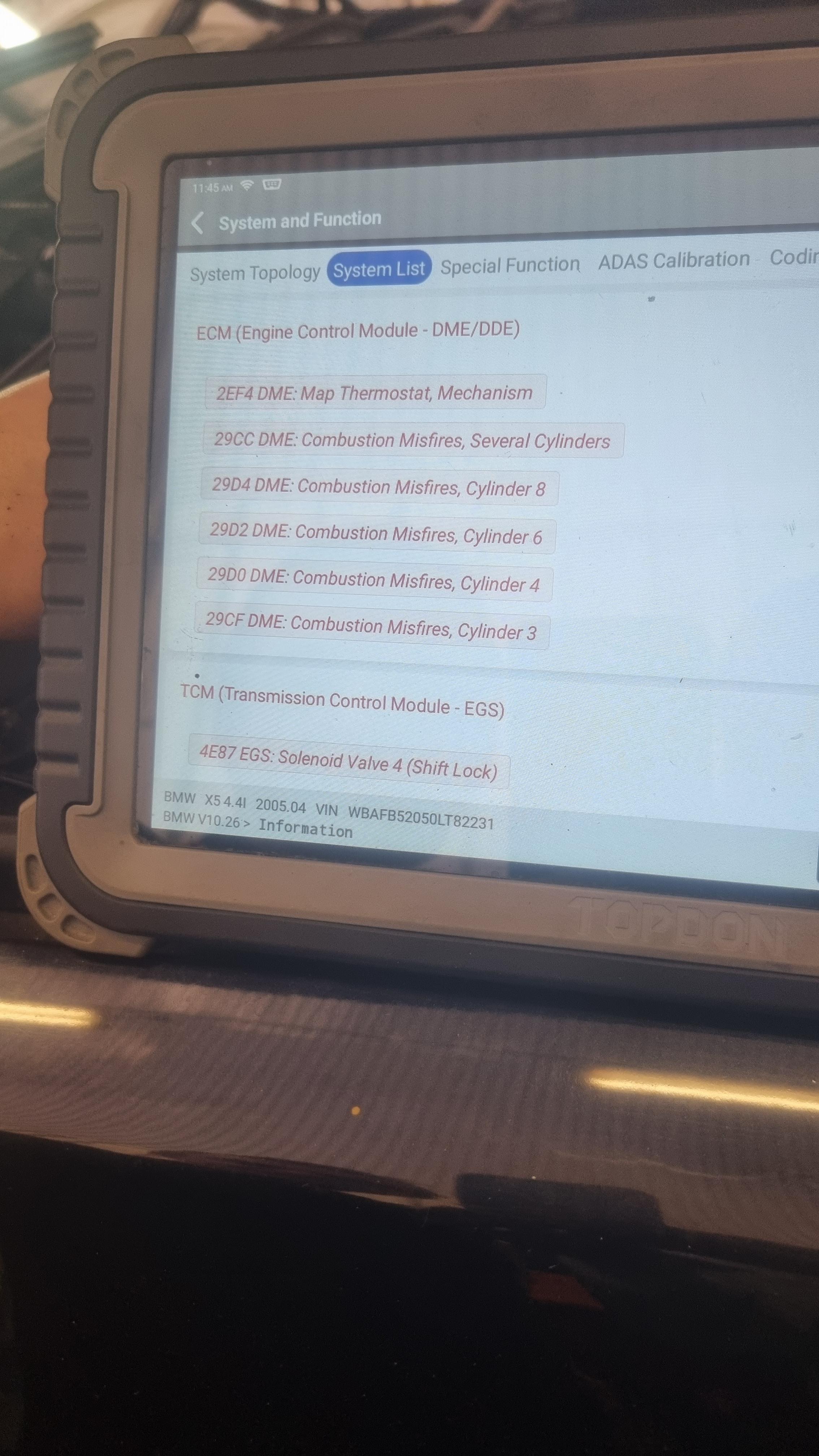

20231010_114517.thumb.jpg.3a902e3fe1d5b0f54f57f3ed32e8e0be.jpg20231010_114524.thumb.jpg.799b35514c2ff98a16262213e01697d1.jpgHi Everyone,
I have a an issue with my 2005 bmw x5 4.4i V8. It has a DMe combustion misfire from different cylinders. I've changed the coil pack and spark plugs but that has not helped resolve the problem. I need urgent help fixing this issue. I live in South East london and took it to Stephen James BMw in Woolwich....they were absolutely useless. My car came out worse than it went it.
Any recommendations of a garage or technician within or outer London who is good at fixing this?

I would start with basics check all vacuum lines and the inlet for any air leaks, then the Vanos solenoids. Then check carefully the loom that feeds the coil packs for any signs of rubbing and chaffing. Repeat with the loom for the injectors, a misfire can be fuel or spark related
If that is beyond you then check out the specialists register
