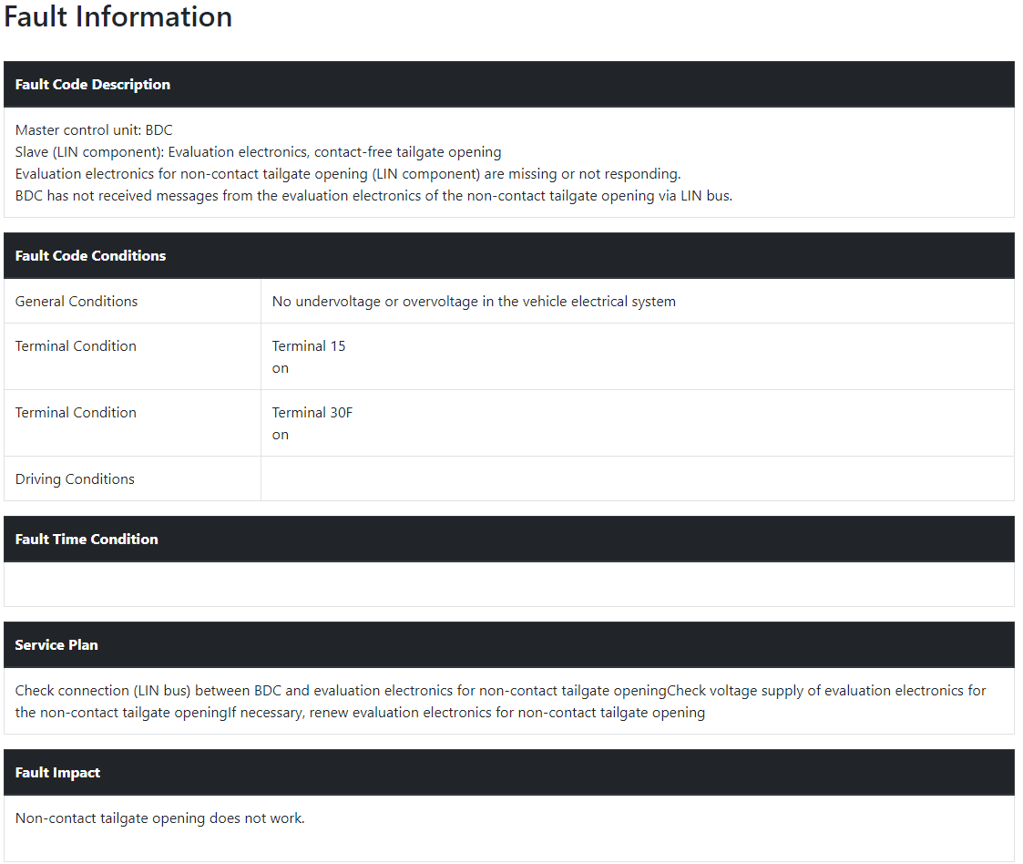

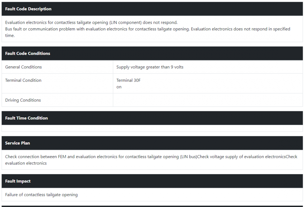

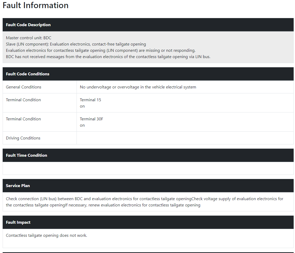

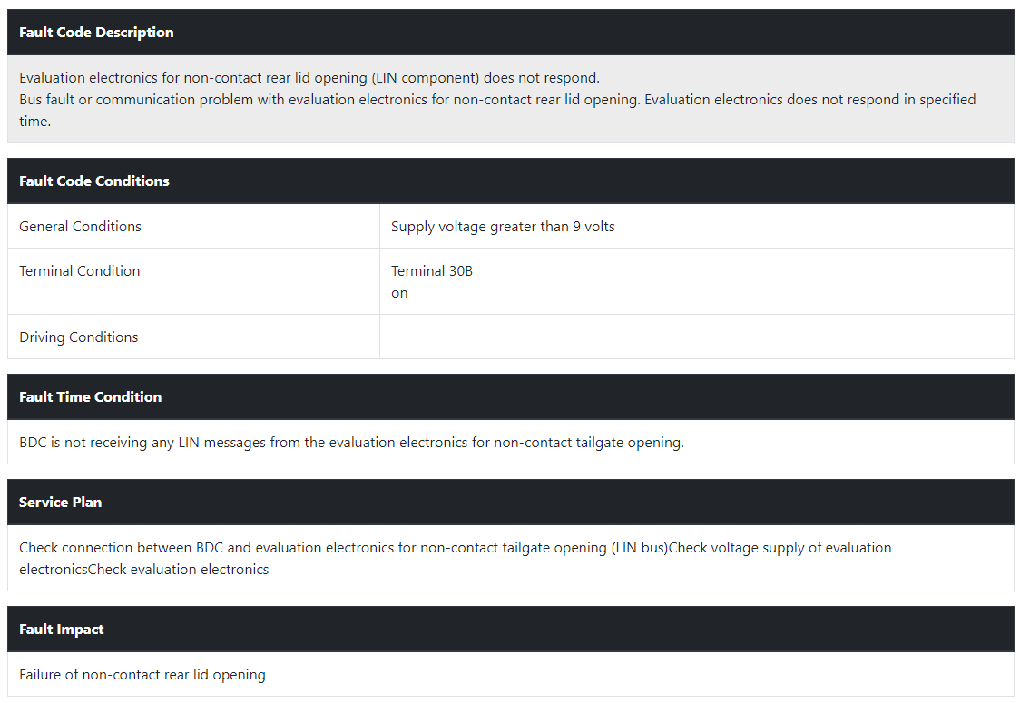

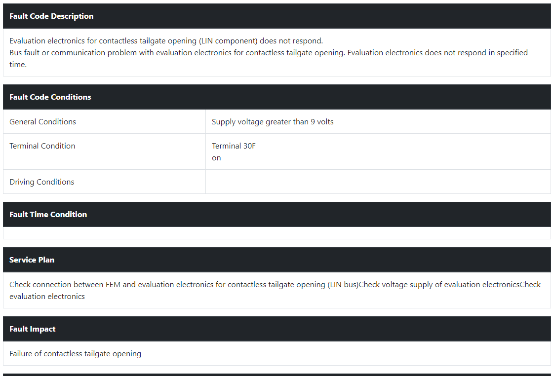

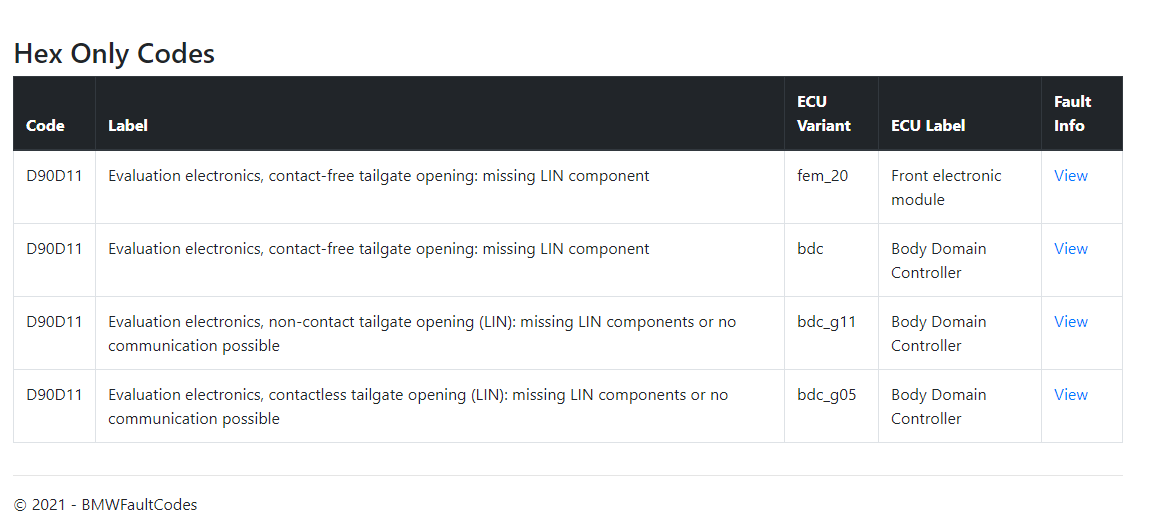

Checked the error codes from a carly from a friend.
This is what came up for D90D11
Any thoughts on how to fix this? Please?
Among the four entries, there is a details page for each (in order)
1.
2.
3.
4.
Morning Bharath
That is very long winded, I would start by checking the sensor (if you haven't already) just in case there is a poor connection. Check online to see if there is a continuity value you can check with a multi meter. If the fuses are OK and wiring checks out plus if the boot release on the fob still operates, then consider changing the sensor.
