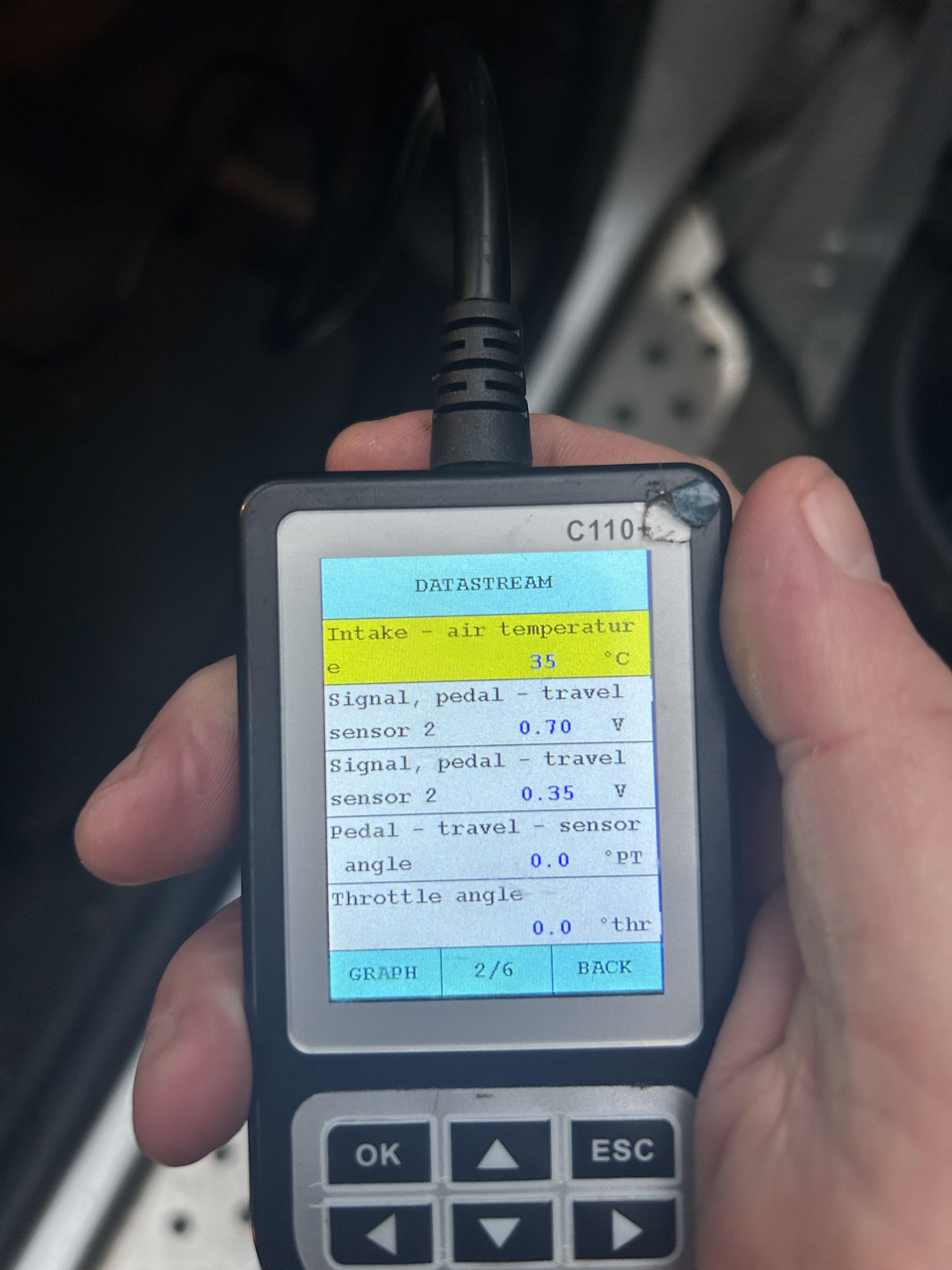

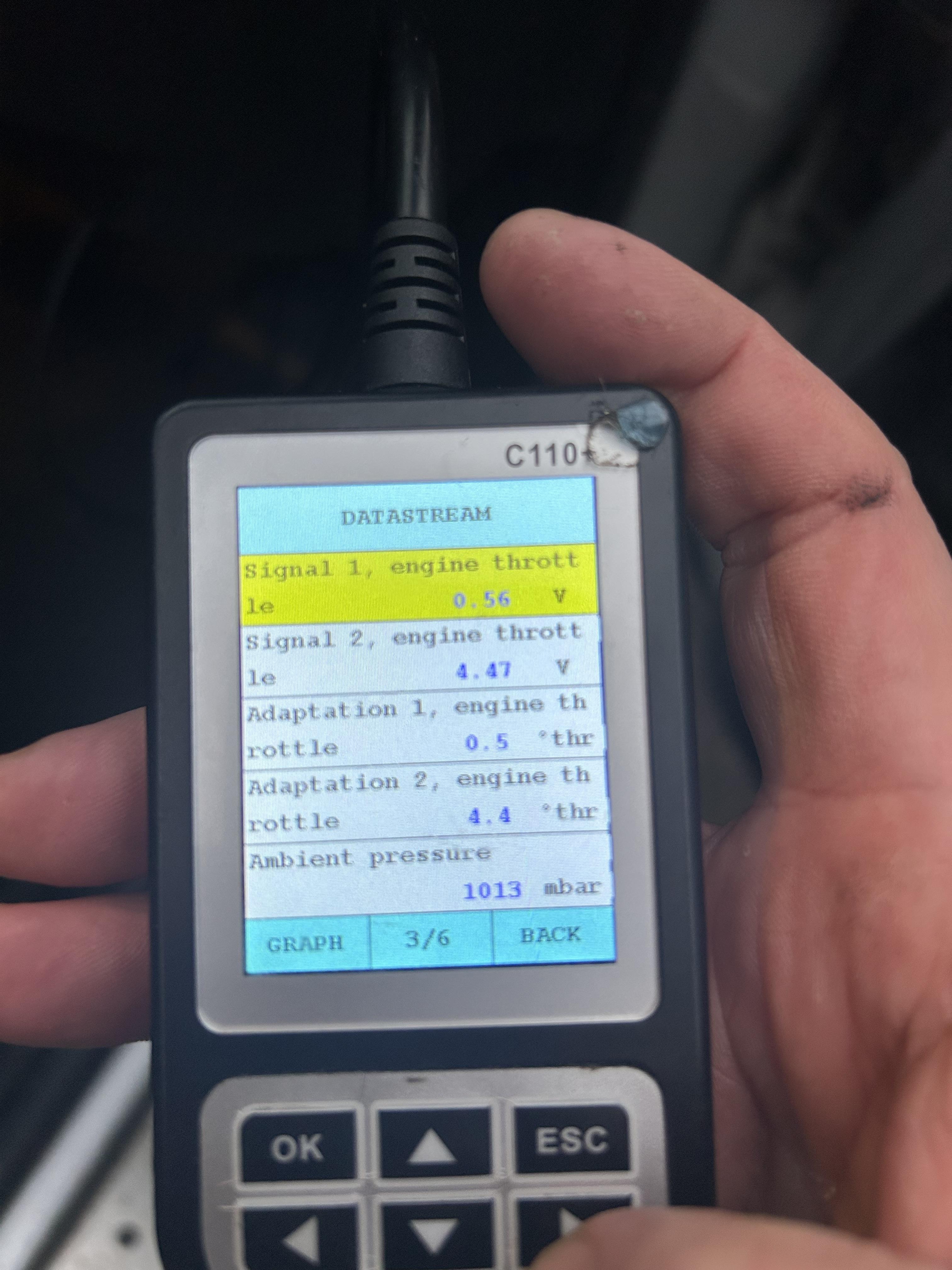

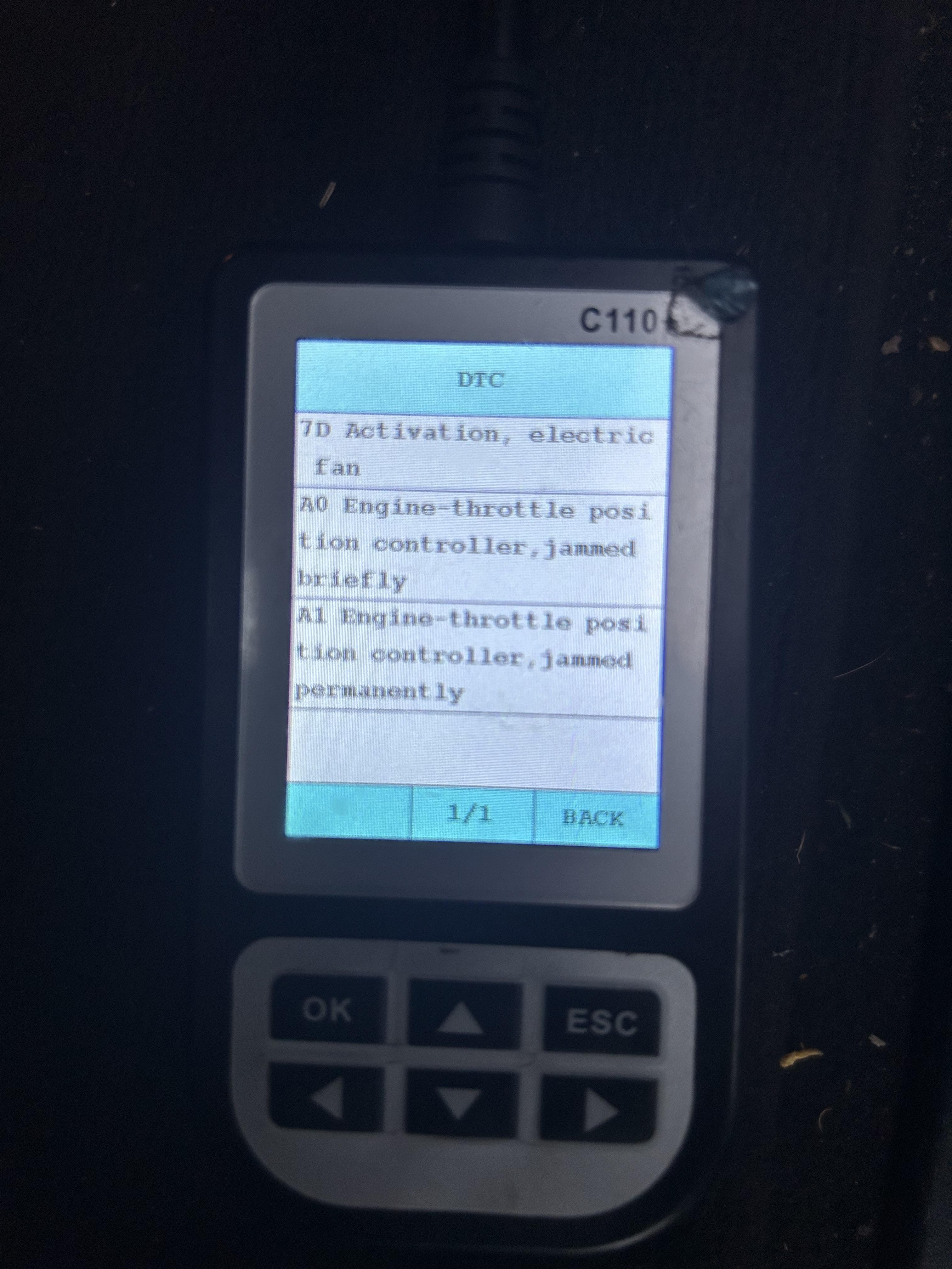

Fault on the scanner is showing throttle position sensor jammed or something… I’ll post some pics.

Looking at your scanner the throttle body is sticking so needs a clean out
