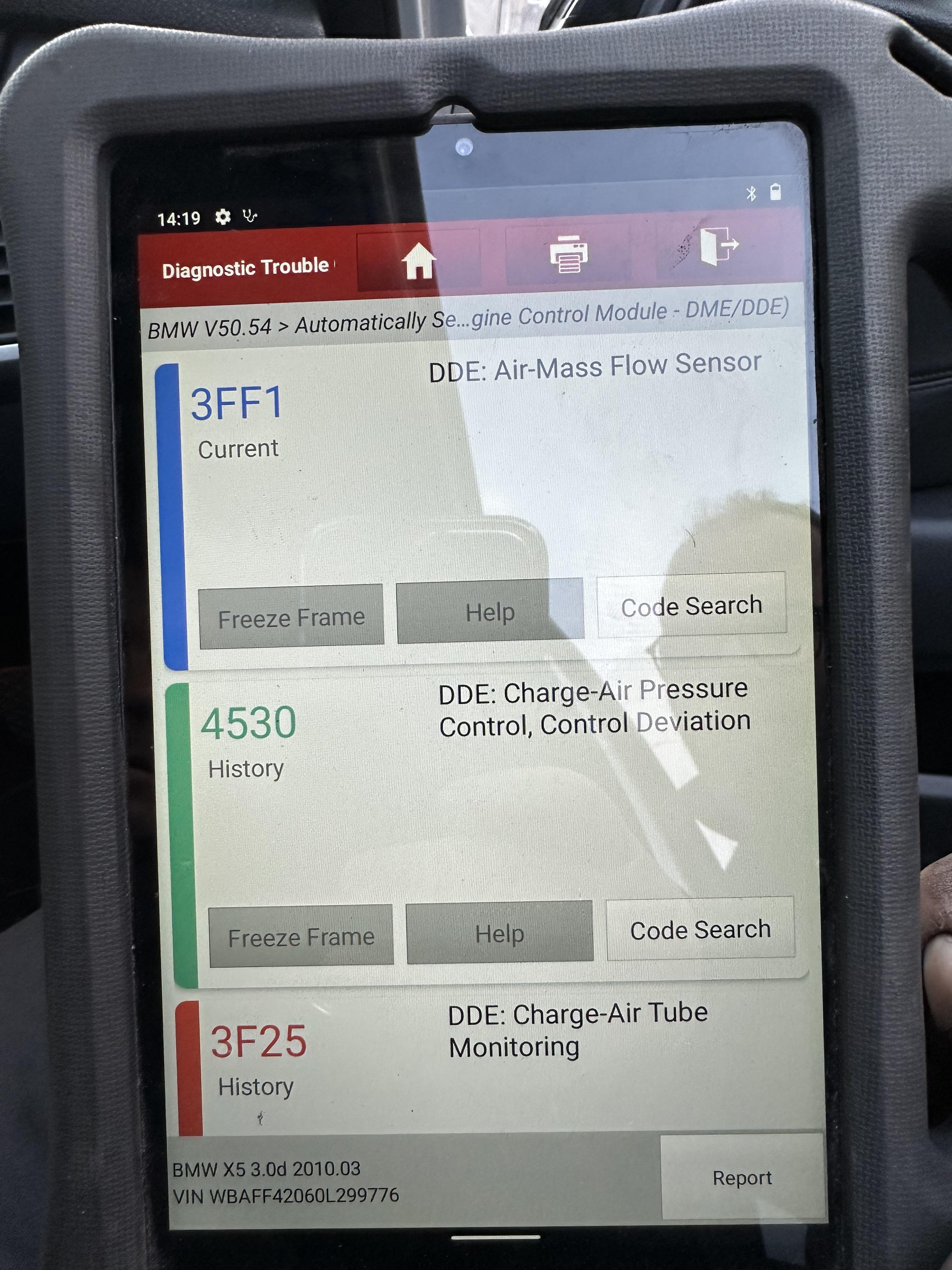

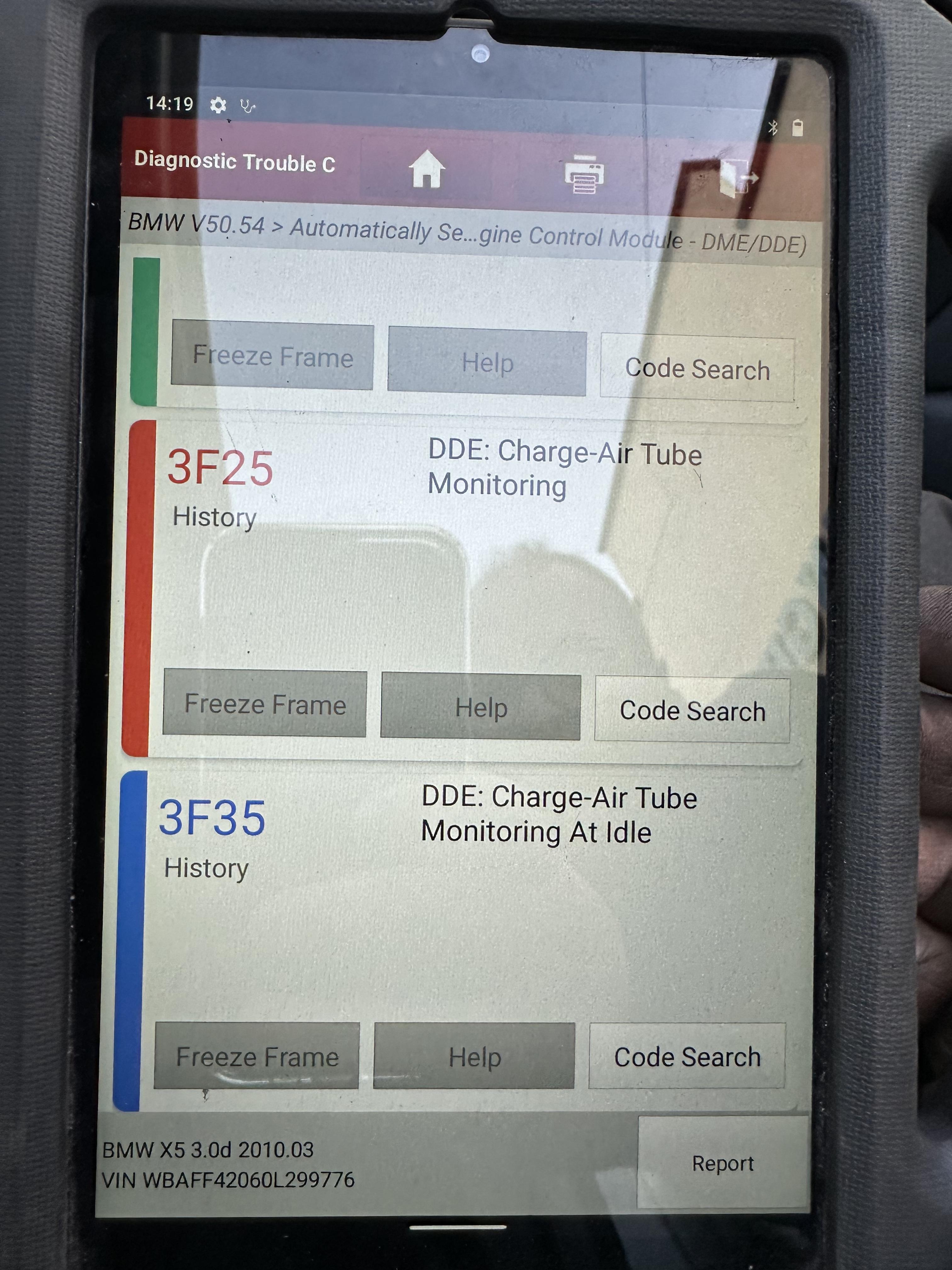

Hi Dave, just wanted to respond and say thanks for your reply. I think the pressure converter that was replaced at the same time as the EGR valve is a bit of a wonky party. I also had the codes read and it turns out one of my glow plugs is dying/dead, so need to replace that as well.
