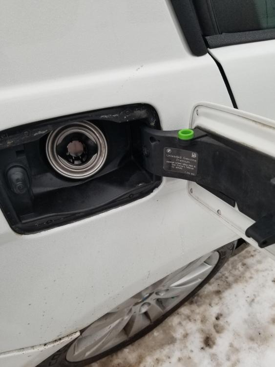

Maybe the fuel cap fixed it after all.  We drove down some positively spooky mountain roads in  light rain mixed with heavy fog by an abandoned sanatorium (Nopeming) at midnight and it didn't stumble or stall or even get a rough idle even after driving for two hours and letting it idle for 30 minutes.
Maybe it had to have a drive cycle without the massive vacuum leak for the computer to realize it didn't have a massive vacuum leak anymore.
Maybe one of the ghosts at the abandoned sanatorium fixed it.
Either way it ran fine for once lol

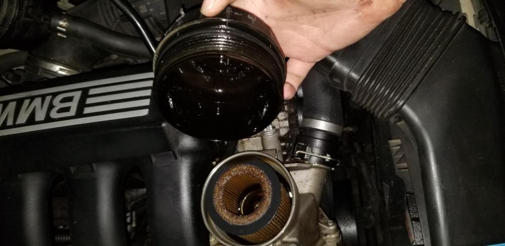

This time, I immediately restarted the engine, pulled into a parking lot, and pulled the oil cap while it was still idling like crap to see if I could tell anything.  It was nearly impossible to remove the cap due to the vacuum pressure, and when i finally did get it off, it made a howling whistling sound like a very intense windstorm would make in an old house or maybe like a furnace with a clogged filter.  Sticking PCV valve?
