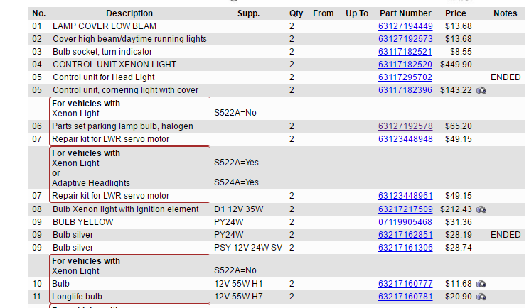

How weird that realoem doesn't mention them, it's normally my "go too" place and hasn't missed before. I run a 4.6is E53 so the lighting is very different, I modified my headlamps so I have LED Halo's as DRL's and the parking/sidelight is just that.

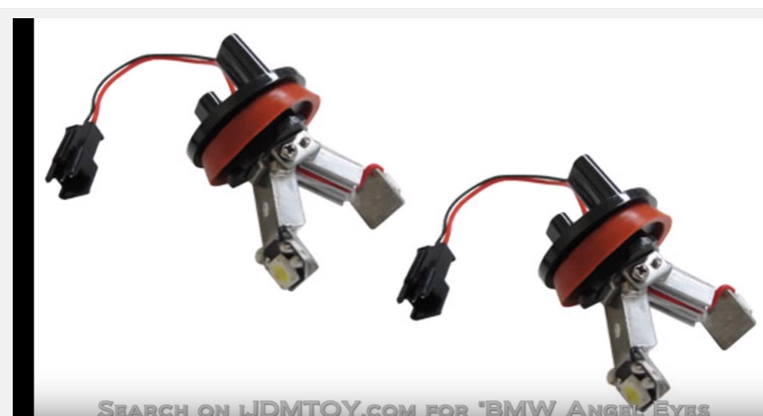

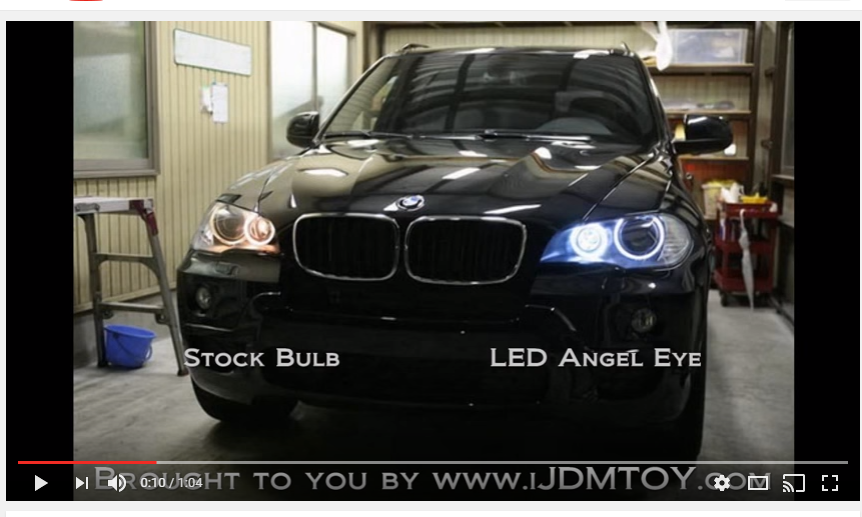

Have you tried a YouTube search? just in case someone has had similar issues and posted a vid?
And this
https://www.youtube.com/watch?v=8JgeN4Qn3T8
Why do Car manufacturers (and its not just BMW) have to make something so simple into a Krypton Factor test needing the strength of a giant in a child's hand with double jointed 3 ft fingers?????
Guest Mr Baldy

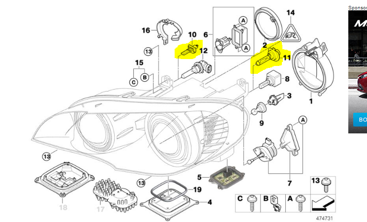

Thanks for the info but unfortunately these lights are different. it looks like a square cover with two torx screws is where i need to get at. loads of fun! the best thing is that my fingers are like bratwurst sausages. The cover is behind what looks like some kind of plastic framework struts/supports.
Number 6 in the above picture.
