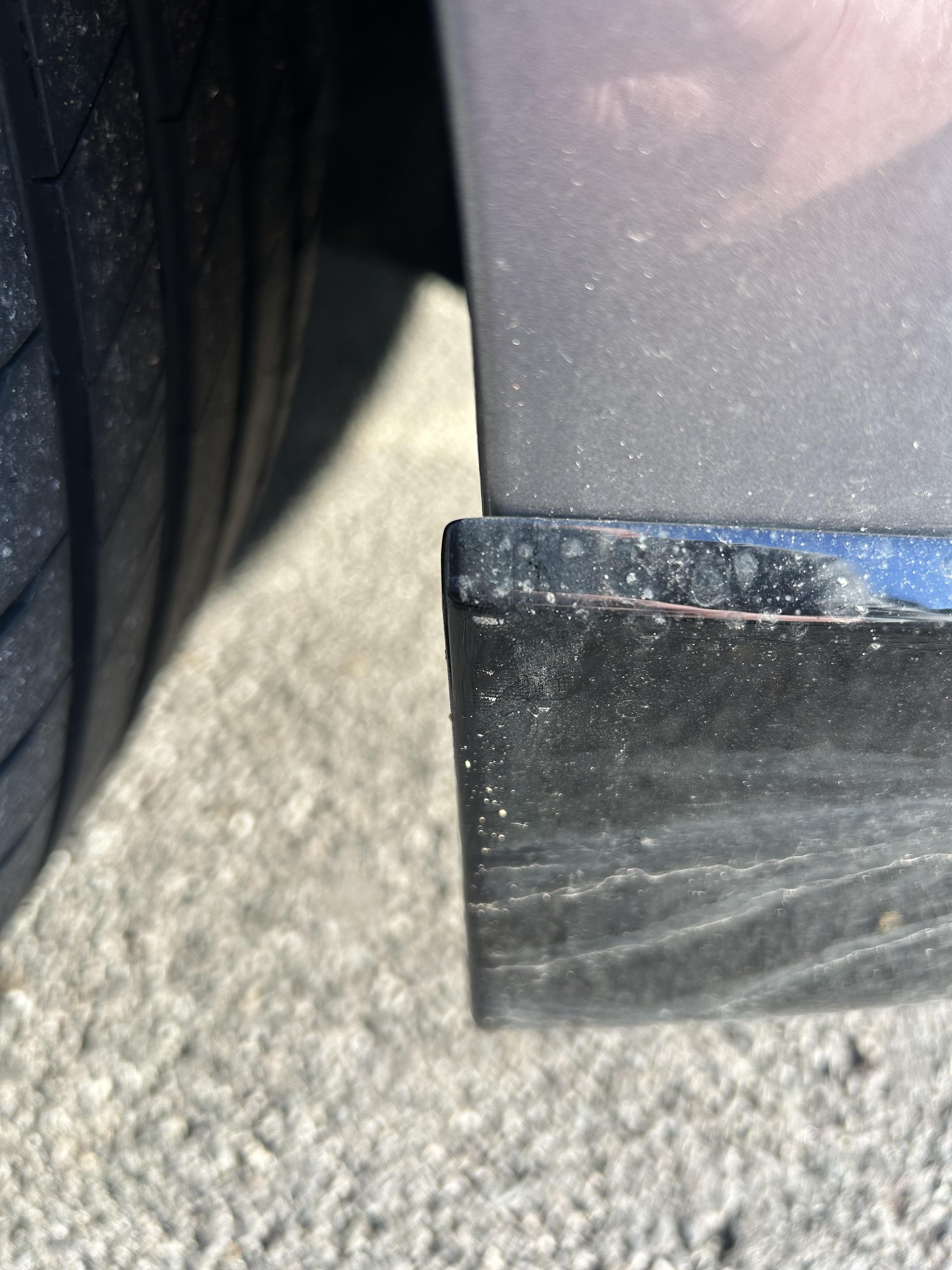

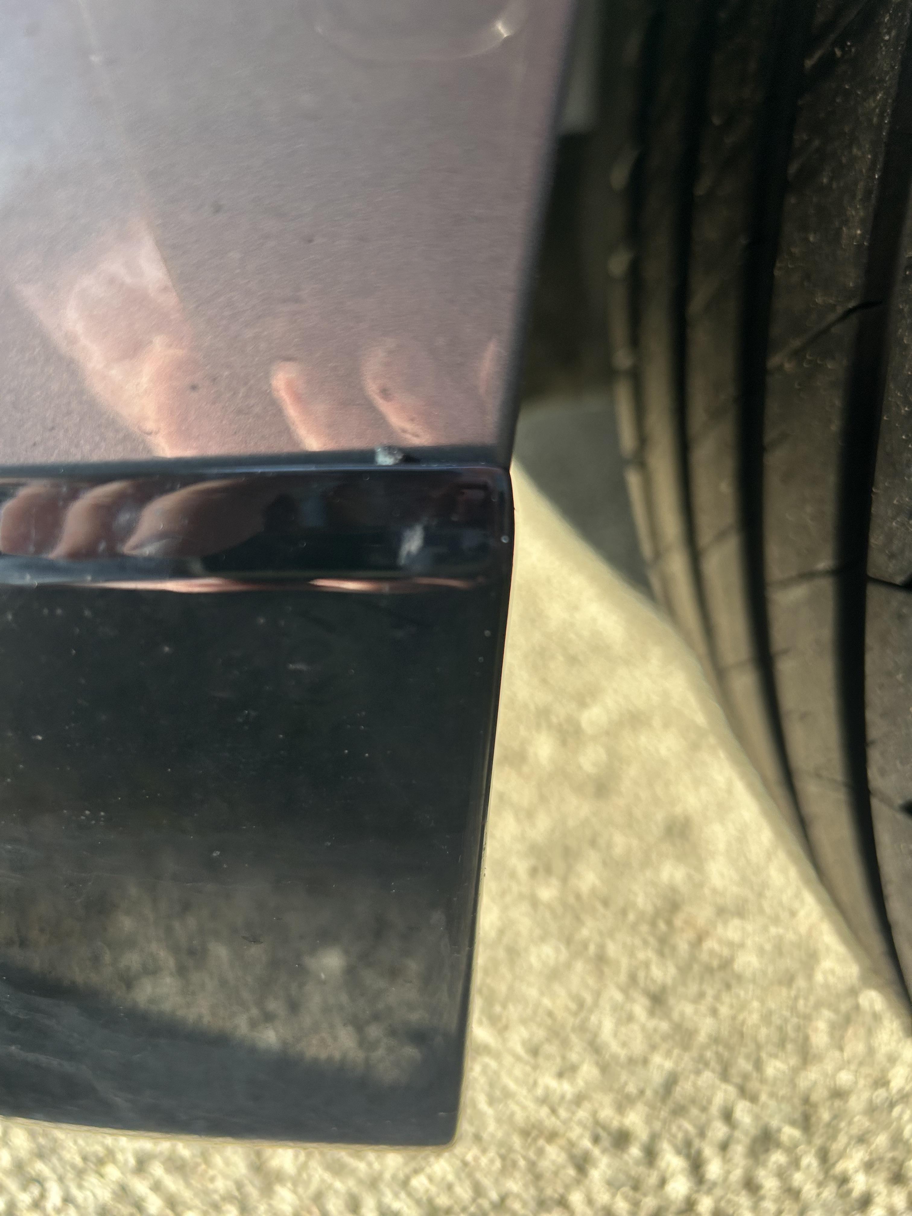

Hi Dave Many thanks for the welcome and pointers . All of the tyres were replaced prior to collection so can confirm there isn’t any debris between discs/pads. The tech was trying to tell me that all M models did this as it’s the compound in the pads which I have never heard of. I had a M235 before and had no issues, wheel bearings not making any significant noise while in motion either. I’m unsure if the pads/discs have been replaced with after market or not but the vehicle has only covered 9k The noise is apparent forwards and backwards with either lock on or off. I have also attached a image of their genuine OEM aero kit fitment which isn’t even flush so I think I have a fight on my hands

With the Aero kit that is quite sloppy work by the body shop I hope it's not Bonded in place

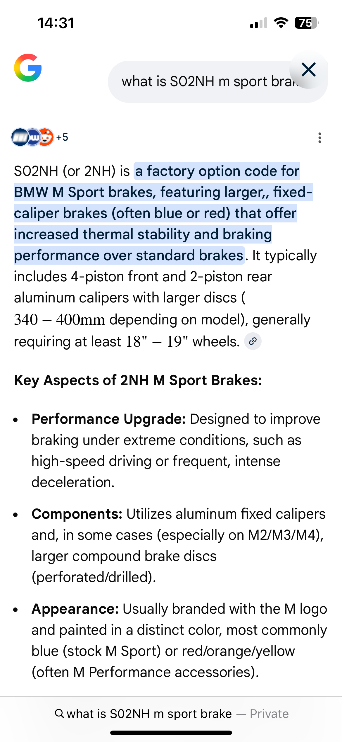

Many thanks I had no joy with the link but thank you anyway, I did a full check with CarCheck uk and this came up. I’m presuming that this is the reason with the upgraded brakes?

Thanks again Dave I had never heard of the VIN Decoder site, looks as if the brakes were an upgrade. Have heard from BMW 7mm on pads and an overall inspection showed no warps. They said to monitor as car has been stood a while, thanks again for ur time
