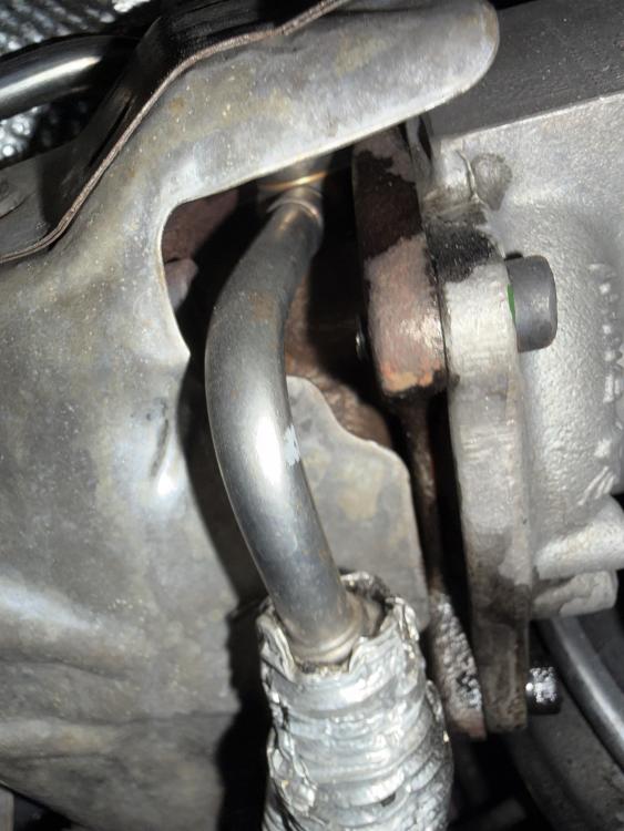

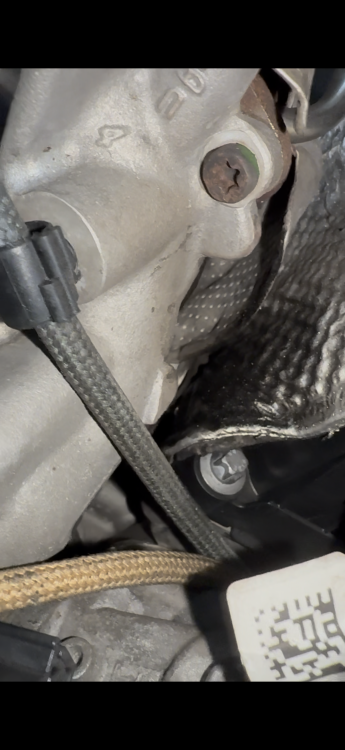

I’ve noticed an oil leak coming from the turbine outlet flange area on my BMW 320d xDrive G21 (2019, B47 engine). The oil seems to be coming from the joint between the turbocharger and the downpipe.
Has anyone had a similar experience?
Any help or experience with a similar issue would be really appreciated.
Thanks in advance!
IMG_5616.thumb.jpeg.993a01fefc529da4eeadfb28a133721b.jpegIMG_5606.thumb.jpeg.3d56b878d37d13e2f253c50fca458d12.jpeg

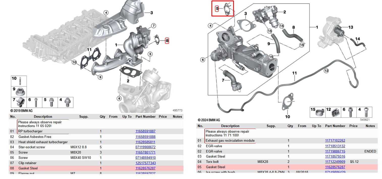

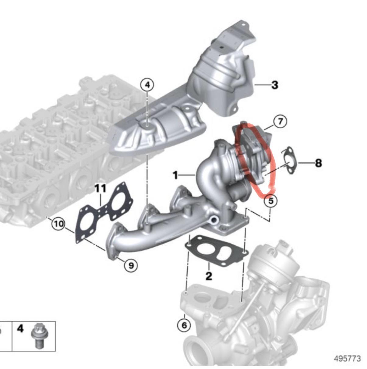

Removing the turbo is not that challenging. The challenge is to find the right gasket..
And here I’m a bit helpless, since no.8 on the drawing does not fit there.  Looks like there simply isn’t any gasket..
Andrew
15 minutes ago, Greydog said:
Hi Andrew
Are you using www.realoem.com ? The drawing looks like it or is that from the Internet?
Is the turbo fitted OEM ?
Hi Dave,
Sure, realoem.
Part number (steel gasket) is 11628576287.
and according to the second drawing (please see attached), this is the EGR Line Gasket.
Andrew
The plot thickens

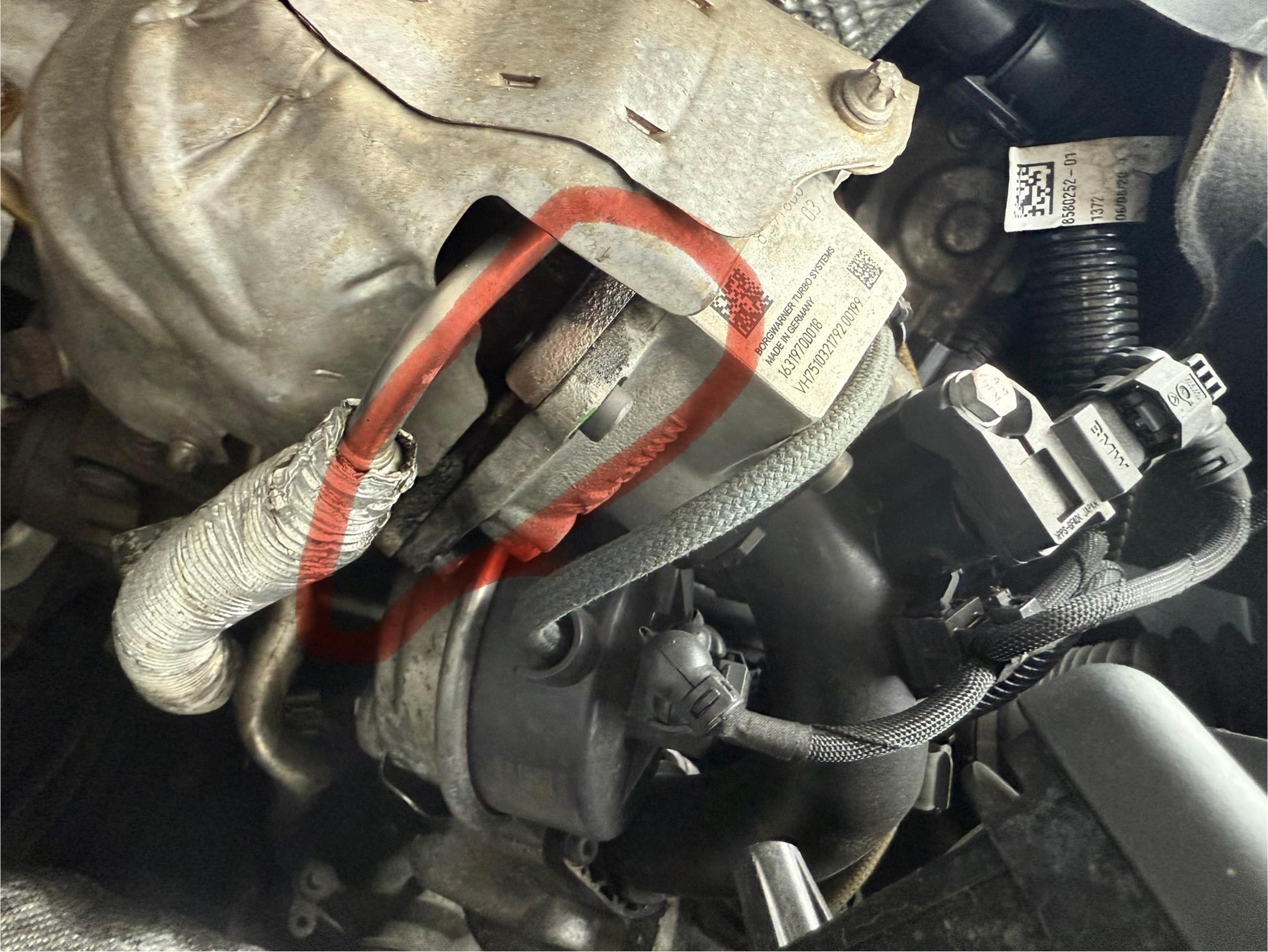

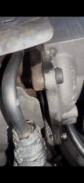

Thank you for your interest in this topic. There is some hope that a solution can be found through joint efforts)
I eliminated the oil feed pipes.Since the first thing I did was replace the sealing rings there.
I am attaching a few more photos showing the leaking area.
IMG_5688.thumb.png.fb4a1640166aba5ce1fb91a5605e0a33.pngIMG_5683.thumb.jpeg.5b5a4389b14982bd606a59e91d788069.jpegIMG_5687.thumb.png.7833dfc2a08c2ad3feca94fc16cb2bf4.png
Hi Andrew
If the oil pipe seals being replaced didn't fix the issue and you have no other leaks in the area then the next step would have to be remove the Turbo and separate the flange where you are seeing the oil. I would expect to see evidence of the leak there.
Good Luck
