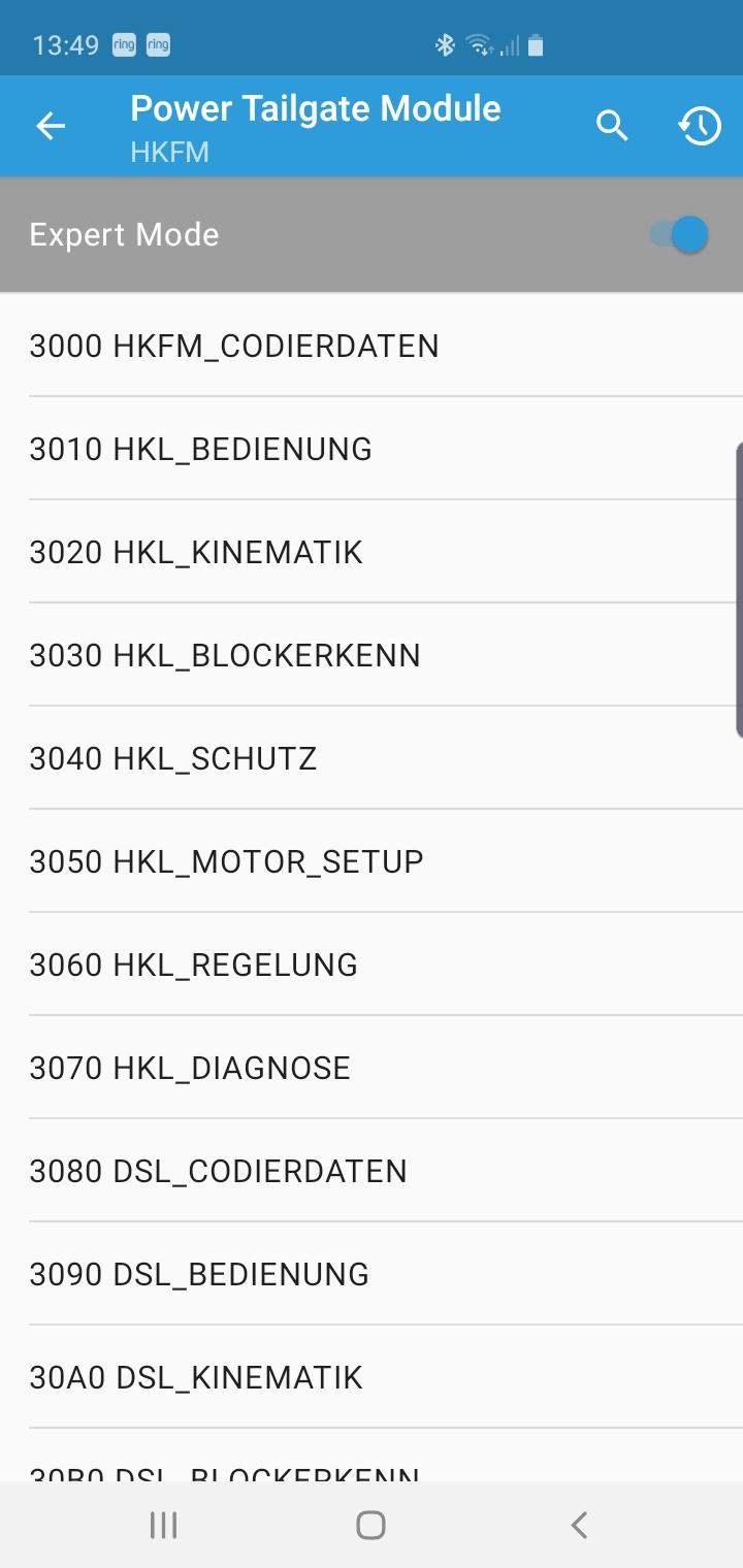

I am looking for help to try and recode the tailgate on my X3 F25 2016 model.  The tailgate slams shut and is a bit concerning. I believe it can be programmed to do a soft close.
I have looked on my Bimmercode app but cannot see where to alter the setting.  Its all in German of course. Below is the menu after selecting Tailghate Module.
Any help appreciated.
Hi Chris
First one is pretty straight foward Coding Data, Second = operation/service, Third = Energy/Power (guessing here) Fourth= Block Detection (similar to windows), Fifth I think is Protection (may be here you find soft close) Six says what it is (could also be where you find what you need) Seven = Regulation (could also be what you need) Last is Diagnostics or Diagnosis (I wpold check there first in case a reset sots it)
Hope that helps, my ISTA/INPA gives all in english so easier to use never looked at tailgate programming Diagnostics should let you know if it is the close  sensor or programming
Good Luck
