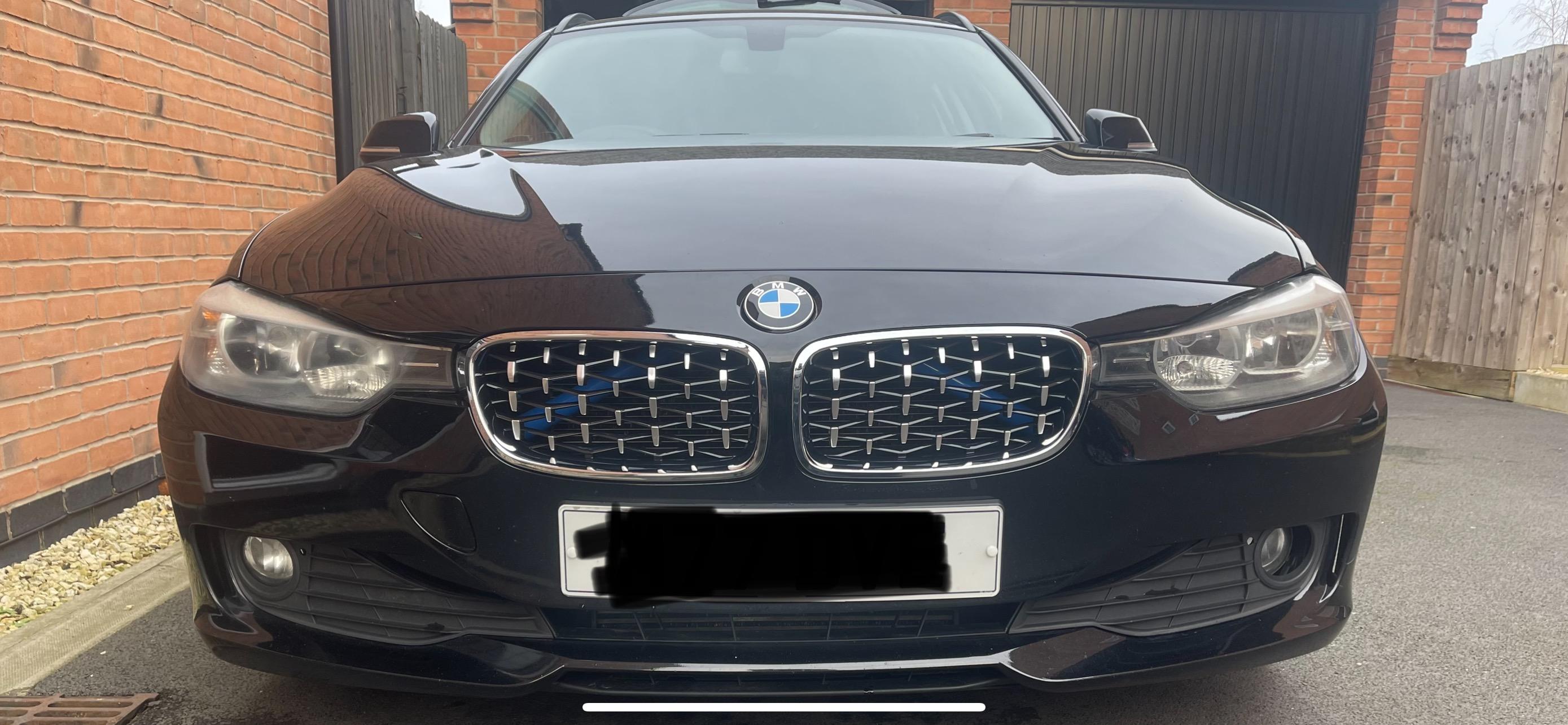

also fitted some new front grilles which I’m particularly impressed with.
