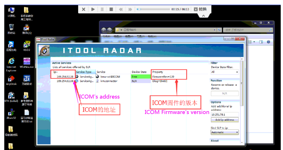

The problem from our customs: I am having problems setting up having problem communicate with ICOM it’s not connecting so I need to get help from you
BMW-ICOM-NEXT-ABC-with-Software-Plus-EVG
Solution way: upgrade the firmware, please refer to the steps below.
Step 1:
Step 2:
Step 3:
Step 4:
Enter the BMW ICOM address of the first step,
Such as: http://169.254.92.38:60080
Must remember to add to the port (:60080)
Step 5:
