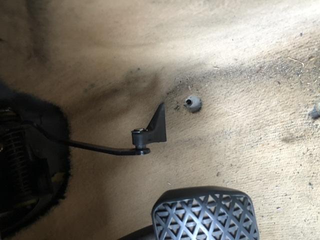

Just bought my first car, I’m having problems with the gas pedal not returning to idle, I lubed the throttle return spring, tightened the throttle cable, and it still won’t come back to normal, does anyone have any ideas on what it might be?

Is it the pedal physically not returning to rest or is the revs that are not returning to idle?
If its just the revs and not a physical problem with the pedal movement then it could be a vacuum leak which is holding the revs up

F1B4D64A-F879-46B6-AAFB-520B75DBD334.jpeg.c8e3d2e26b6dd183ac0d2d81744039e7.jpegIt’s the actual pedal not returning, it didn’t have a pedal before I got the car, and when I put a new one in it didn’t return back to idle. I cleaned the throttle body today and reset the sensors in it, thinking that would help but the only thing that happened was my rpms lowered. I’m thinking it might have something to do with the spring at the top of the bar
Morning Daniel
Have you looked at www.realoem.com put the last 7 digits of your vin in the search box and it will bring up your model.
You will find exploded drawings which may help in (a) knowing the peddle fitted was actually correct for the car (check part numbers) and (b) how it is fitted together.
Also as Trevor pointed out check all under bonnet parts as well
Good Luck
