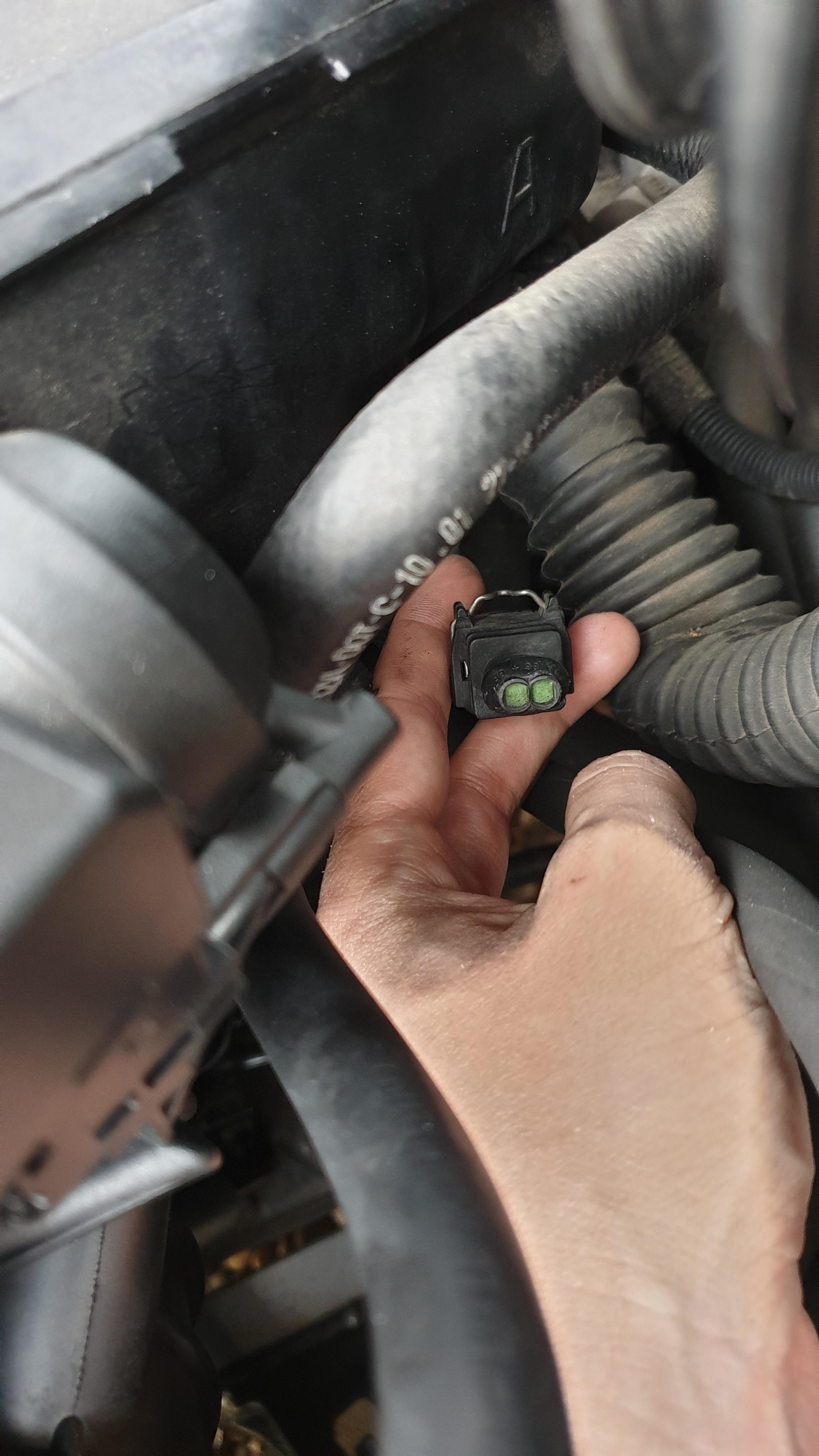

When I was in the process of disconnecting everything and came to remove the throttle body i notice a connector hanging loose to the right... further around the back of the engine and looks as though the wire is clipped up/fastened. I believe it's where the EGR is on some of the BMW engines?
Used a mirror try and look further behind for any sockets missing connector but cant see anything?
Ive attached an image - Please can someone advise? Makes me nervous having a connection just hanging there with nothing to plug into

It looks like a dummy connector to me....as you say it is probably there in the loom for an EGR had it been fitted to the engine at the factory.
