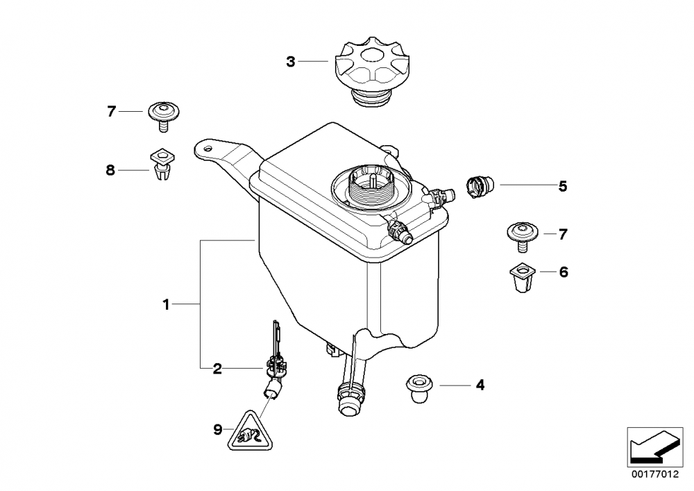

Morning Neal
A Bilstien variant ? Is the tank the same as the one in the drawing and is the part number  17137542986 or different ?
Have you had the codes read and reset? which may clear it other wise I would still suspect the level sensor even brand new stuff can have a fault. if you still have the old tank try swapping the level sensor.
