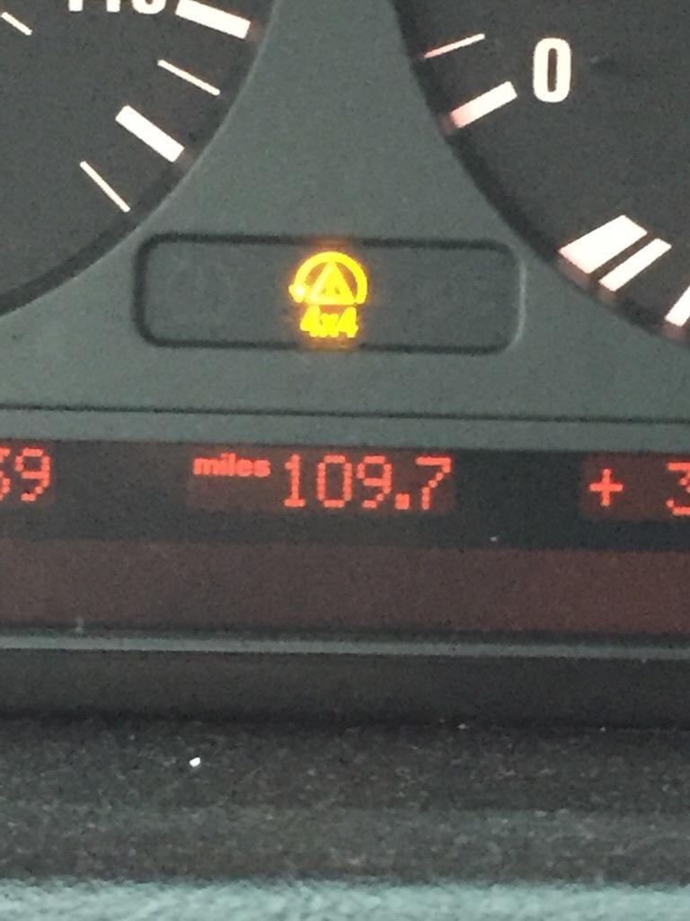

Something new I have noticed though is pressing the DSC button gives me the 4x4 warning light I am doing some digging today to find out what it could be, does anyone here know what it could be?

Not sure if I'm understanding you correctly but if you press the DSC light it should invoke the 4 wheel drive to ensure stability is maintained but not taking full control of the vehicle...e.g if going off-road for example, where you wouldn't want the DSC taking over?

Attached is the light that comes on, I had read it was an error? Or is it just telling me 4x4 is on lol 🙂

Not sure what you are asking here Adam? Does the light come on and go off with pushes of the DSC button? When the light is on your 4 wheel drive system is compromised a bit like traction control off on a 2 wheel drive car.
The light on can be caused by a lot of things unfortunately, ABS fault, Transfer case issue, Steering angle sensor to name a few. You need the codes read to be sure of exactly what the issue is or in fact if there is one at all.
It only comes on when DSC is pushed. Previously it was on all the time but i changed a tyre and the rear pads and its gone away, unless DSC is pressed
