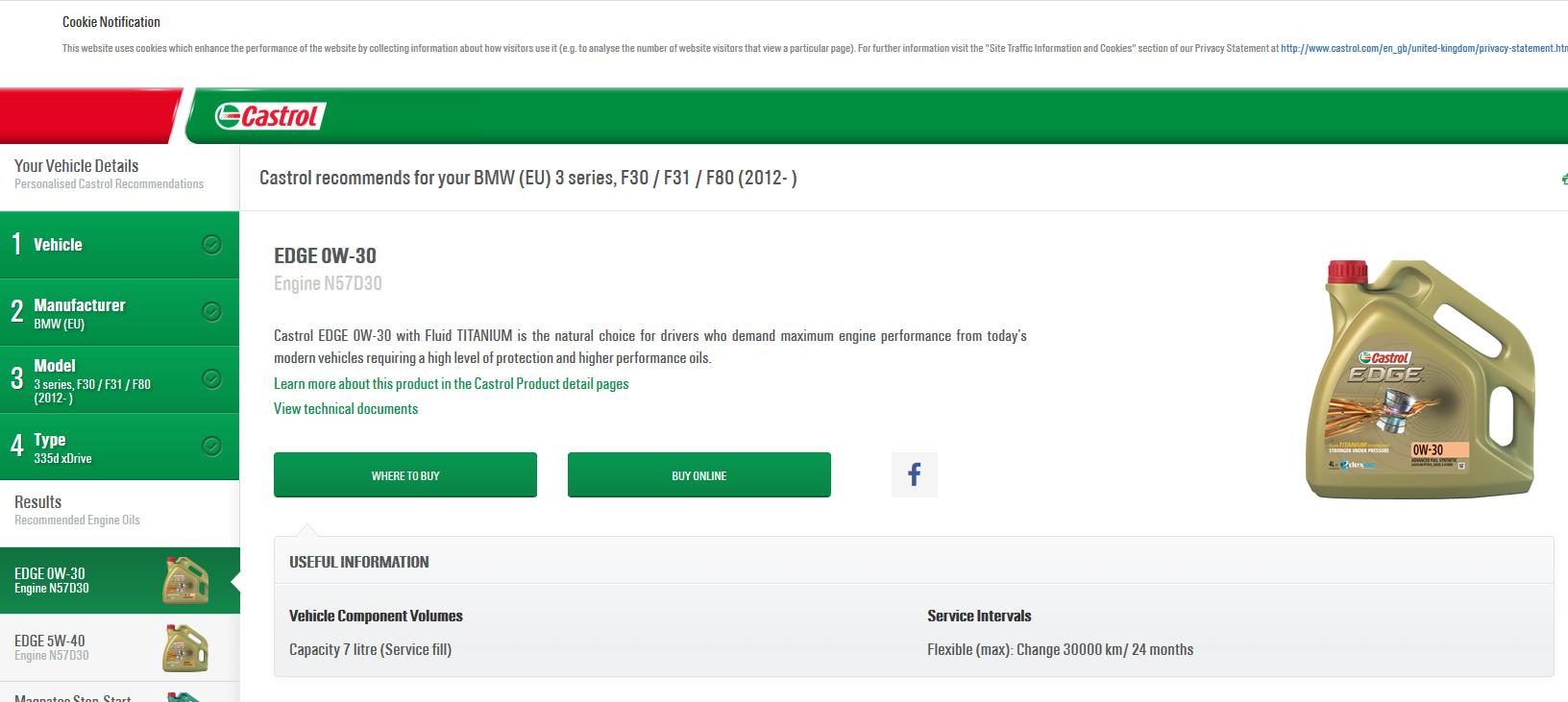

Hi Trevor,
Thanks, for the link, but it doesn't actually say anything about actual capacity / amount required ..... I've managed to speak to Opie Oils, who state 6.5L

Thats what I thought although the castrol link kindly shared says 7.0 litres?
My opinion Castrol are selling oil, if you ask them why they quote more than the manufacturer they will tell you its for "topping up"
When the Dealer was servicing the X5 I always had a pint of oil left in the Boot the car never used or lost any so it would be there at next service they always left it regardless always saying it's for topping up?? Three guesses who was paying for it?? Once the Warranty was out I use a BMW specialist who uses the correct amount (no top up bottle) he is an ex BMW master tech so knows what he is doing (I hope) I also do interim changes at home as I have never trusted extended service schedules.
