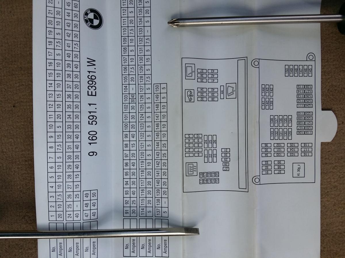

I have checked the 20 Amp fuse under the glove box. You are right, it does need some doing to reach there. 3 screws to remove and then on green to twist.
All 20 amp fuses were good. One "118" in the boot was missing and I replaced it but did not produce any result. Interestingly all three power sockets ( 1 cig lighter and 2 Aux power outlets) are not working. Is there one master fuse for this ? I thought 118 was the one but did not help.
I am enclosing the fuse placement diagram I have in my car.
Any suggestions please?
Thanks once again for reading

From what I understand yes Cig lighters and power outlets are all linked. You need a wiring diagram to be able to check, I would guess that there has to be a relay in the mix somewhere. Have you checked the fuse/relay box in the engine bay? Passenger side up by the windscreen.
I haven't looked at realoem to see if there is any help there (its helped me a couple of times) or search for wiring diagrams on the net.
