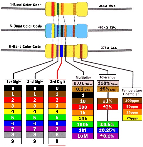

Resistors are generally colour coded so replacement is generally a like for like swop.
