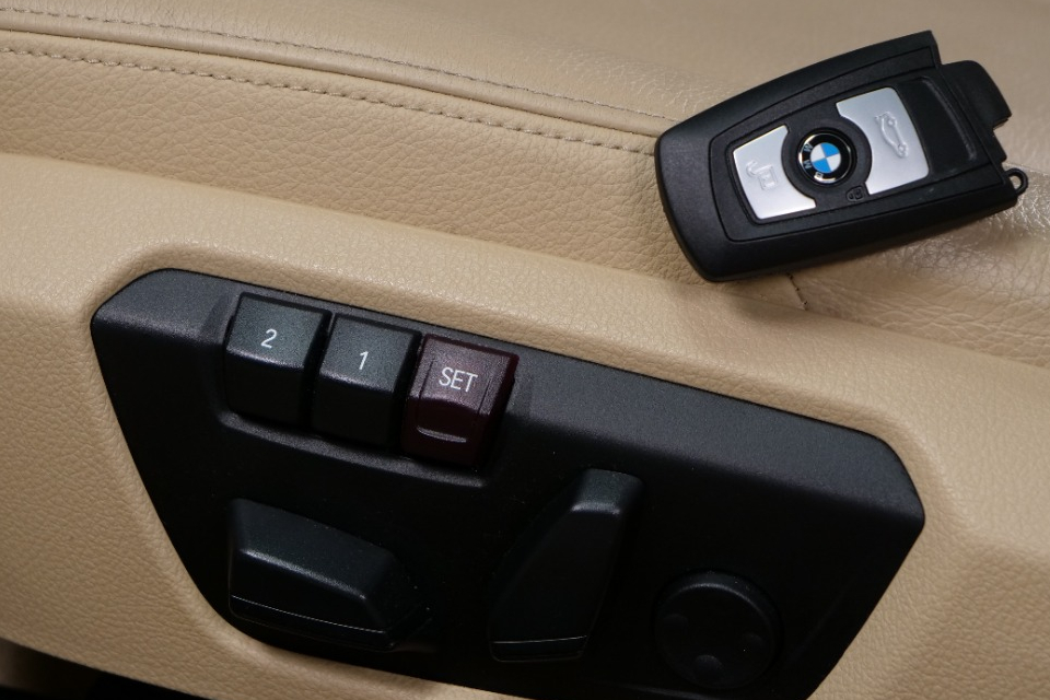

BMW Key Fob function available in F/E/G-Series models.
Have you ever had to change your seat position, mirrors, lights, air conditioning, door locks or other car settings after lending your car to your friend? Or maybe you have to do that everyday, as you share your BMW with your spouse? Anybody who has ever been in one of those situations knows how time consuming everyday car adjustments can be.
Fortunately, BMW's from the last decade or so have a function called Driver Profiles, so that all of your personalized settings can be paired up to a certain key fob retaining all of your settings. So, for example, if you and your partner use separate key fobs, and your partner drives with the seat set very close to the steering wheel, the key fob assigned to his/her driver profile will remember these settings and automatically change the seat position from yours to theirs. An array of other settings such as navigation, last temperature adjustments, lights, door locks or mirrors (if they come with automatic folding) will also be stored in the profile.
Key fob driver profiles for BMW
Hence, if both of you use completely different in-car settings and are often in too much of a rush to change up every detail, having two key fobs with different profiles may come out as a huge advantage. If you only have one key left and share your car often, you can easily order another fob from BimmerTech to take full advantage of driver profiles.
