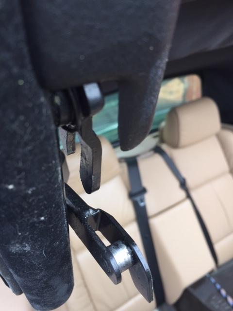

Hi, I have a '99 323i convertible. I'm having several problems with the roof. First and foremost when I pull the soft top up it goes most of the way but the last part from the top frame pivot to the windscreen wont straighten out. When I looked closely the top frame pivot is a fork that should slide onto a pin and on my car the fork is going over the top of the pin and jamming the frame. I've included a photo. Does anyone know how to adjust this part of the roof so that the fork and pin interlock?

Hi Richard
I am not a Convertible owner but looking at the picture I guess the lower section should be in the fork?

Thanks Dave, since I posted I worked out how to remove the cover panel where it attaches to the windscreen so I could see the connecting rods etc. I used a drill to operate the mechanism and have managed to realign the forks and the pins so at least I can now attach the soft top. My second problem remains however that I cannot get any movement from the motors to resynchronise the mechanism. I've tried all the advice i can find about removing fuses, opening the boot, closing the boot, holding down the console switch etc but nothing seems to work. I guess there's either a microswitch that needs adjusting or there's a dead electrical item somewhere but I don't know how to go about testing it.

   I'm having I guess the same problem you did. The fork has jumped track and is below the pin. Did using the drill run the frame on up so you could get the pin back in the fork? I've been manually opening my top for years, but this problem just happened. Any help would be appreciated!!

From Richards description it did allow him to get the top up and I assume down.
